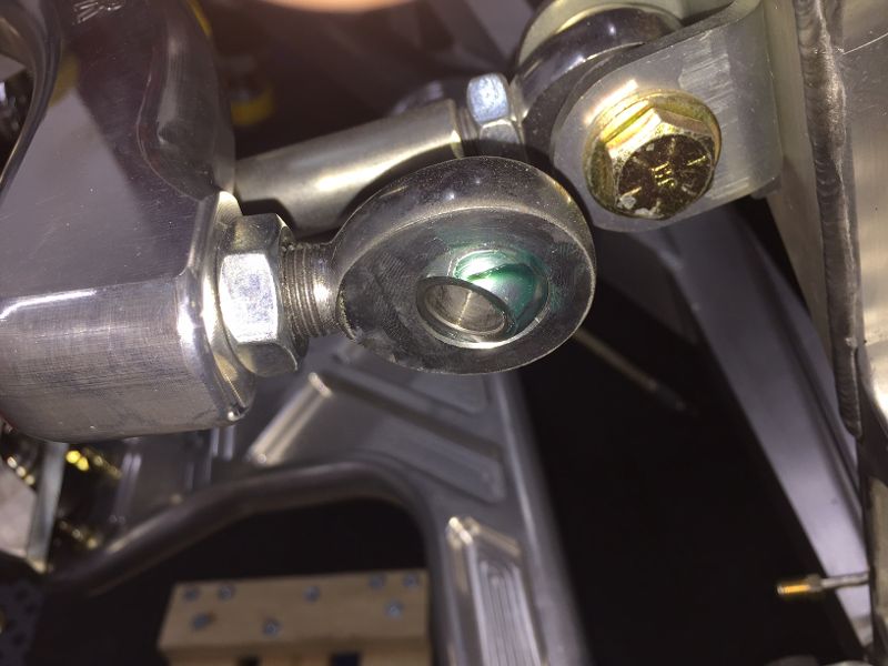

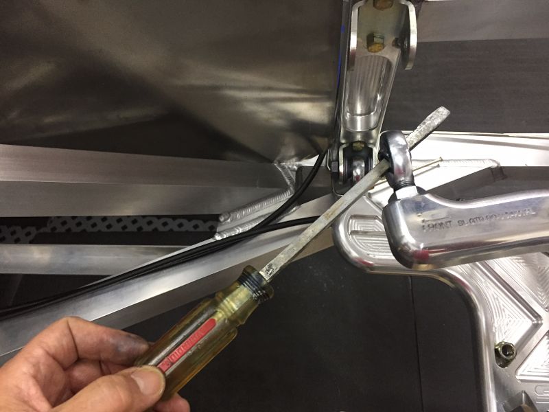

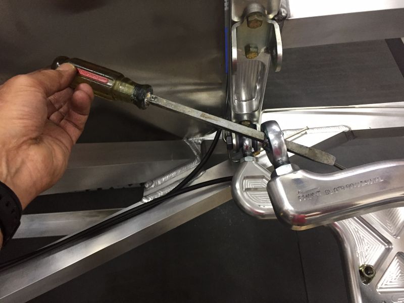

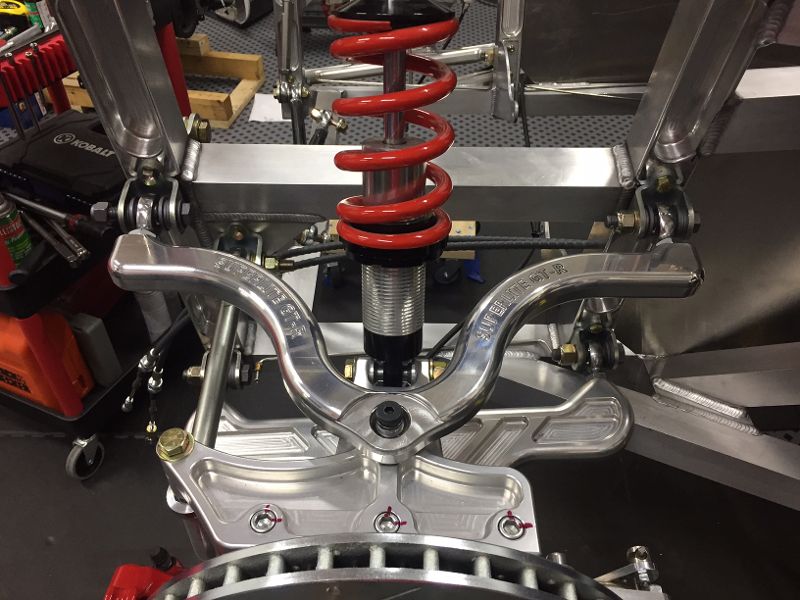

I had my suspension completely together, torqued, marked and ready to go, but I wondered if Scott Rowland's suggestion of using Cerulean was really needed. Sooooooo I ordered some and did my own little test using the ball joints around the transaxle mounting, to see if there is a perceptible difference in friction by applying the Cerulean, completely wiping every bit of it off, then checking the friction. Every surface was wiped free of the grease after the grease was worked in by range of motion. This was not very scientific, but it did not need to be. The difference was overwhelmingly reduced friction. Some of the ball joints actually squeaked when I put them through a range of motion, prior to lubrication. As a result of this test, I spent the day disassembling the suspension to lubricate all of the joints in the suspension. I feel better knowing the friction is significantly reduced. Thanks Scott

No probs Mark. Thanks for doing the test to confirm. It is mind boggling how much of a difference it makes in ball joints. Push all the old/new grease out, and run the Cerulean. Slick stuff.
