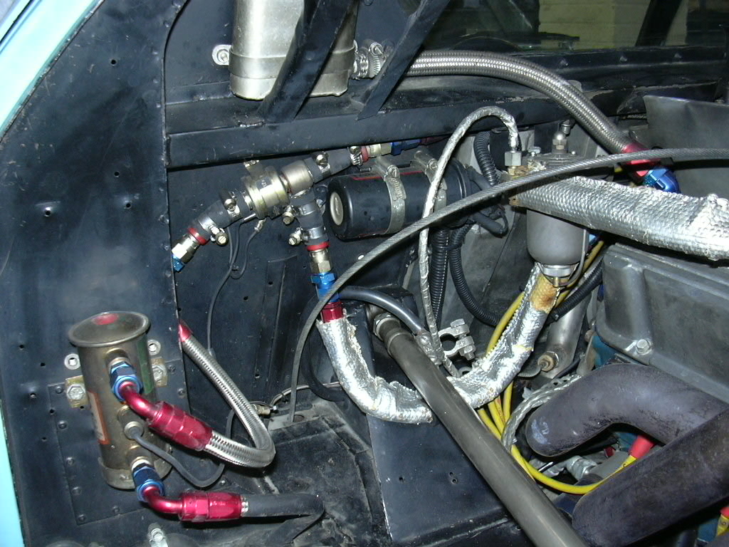

Ian, excellent question, and yes it has happened (to me). My set-up recirculates the swirl-pot back to the passenger tank (configurable with both one-way valves and manual valves), so once the passenger tank gets low, I swap LP pumps to the left tank, which then recirculates back to the right tank, and thus refills it. Yes, I've forgotten to swap the LP pump back to the right side tank, once full, in the heat of a track event, and thus dumped some fuel overboard. I'm not as sharp as I was 30 years ago.

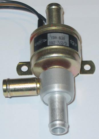

Thanks Jimmy
Any idea what diameter hose they are for? And how much current they draw?
looks like I would need two, one for flow and the other the return. Because I only run two pumps
tank to valve to LP pump, filter swirl and return to tank and a HP one swirl fuel rail and back to swirl.
i also see Moss has them for sale
Thanks for our help!
ian
JimmyMac
It looks like 1/2" hose connection. I have no idea on the current but a call to Moss will no doubt help you.
