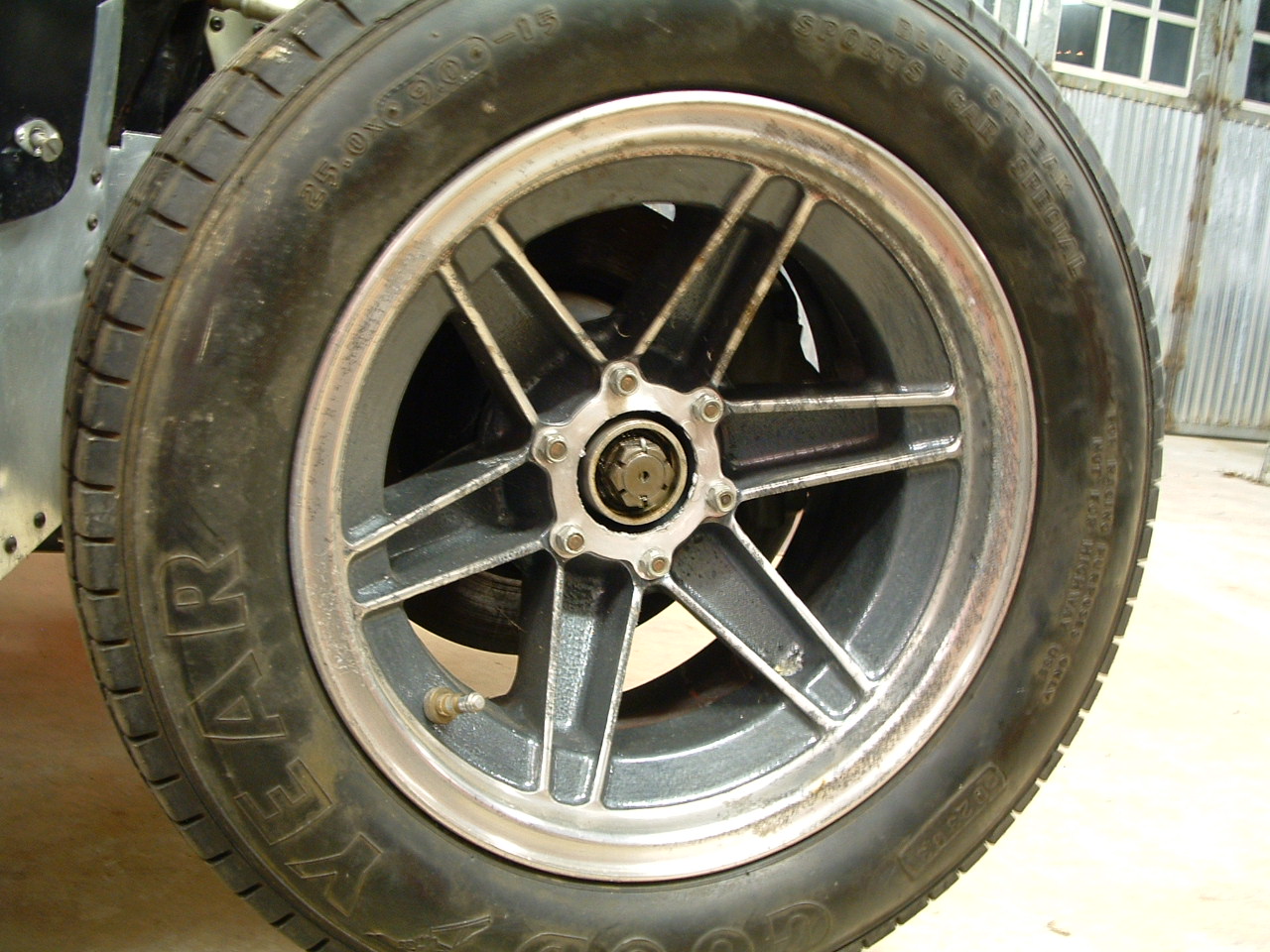

Thanks for that info. It is little things like that issue with the way that the wheels attach keeping me skeptical about the originality of the car.Also, the front aluminum radiator support structure appears to have been fabricated specifically for the radiator, so can anyone tell me if the radiator appears original ? It is a race set-up, not a street set-up, so if it is not from 1966, then the car possibly has later racing history.

Your photo of the front wheel looks like a correct wheel but it kinda looks like an aluminum wheel.
If it's a two piece wheel it is probably a Phil Schmidt reproduction wheel.
All roadsters had the bolt on wheels, coupes had the knock off wheels. F5000 Lolas (T-140/142) had bolt on but used a steel hub, T-70 bolt on hubs were aluminum, Knock off's were steel of course.

David, the wheels are magnesium that have been steel wooled and painted and clear coated. Awful, but fixable ! Probably not suitable for racing any longer, but I have some extras that will do nicely. What size wheels and what type of tires do you use ?

David, this is a better picture of the wheel.
