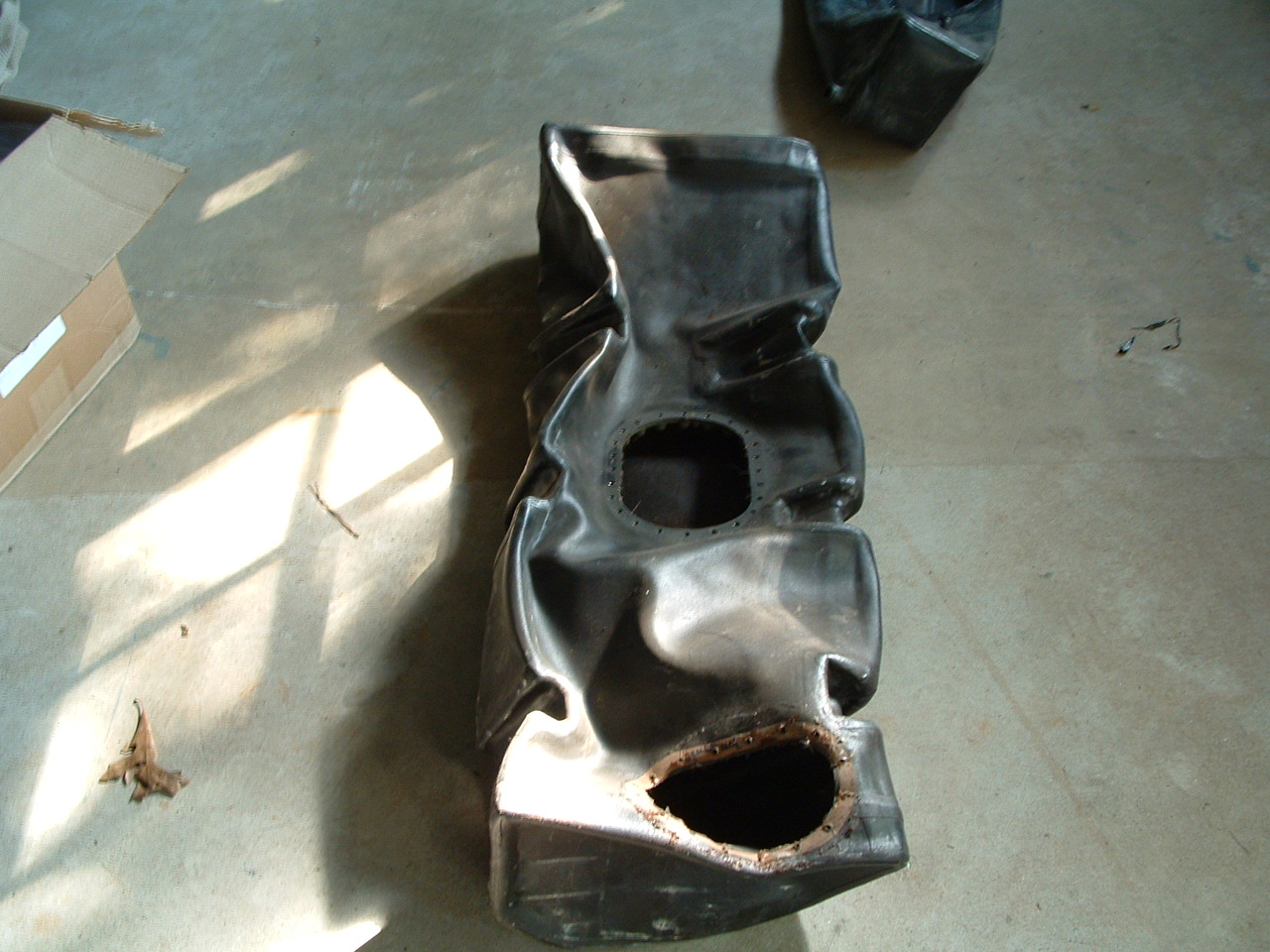

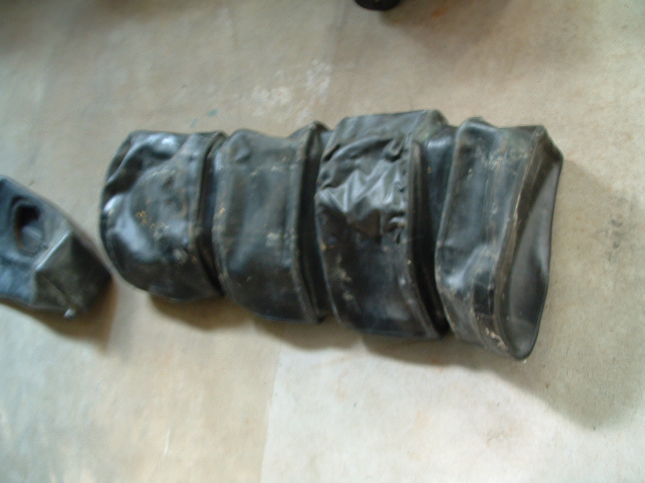

I'm going to restore the port side fuel pod , then add a new fuel cell, but then what ? The Suspension is suitable for street use or track touring, but is really not capable of being race ready. I can replace it I suppose. The car has miles of wiring and accoutrements for the AC , radio, etc. and holds a huge battery over the transaxle. This whole wiring harness must go I suppose. The body is in perfect shape, with 25 year old paint that is almost perfect. A cleaning and wax would restore it's luster. It too must go because the car needs to be a spyder. The wheels are there and there are 2 sets, both shod with new vintage tires, one set of Firestones on gold wheels, and a set of Goodyears on blueish gray wheels. I can't use the tires or the wheels if I want to race.

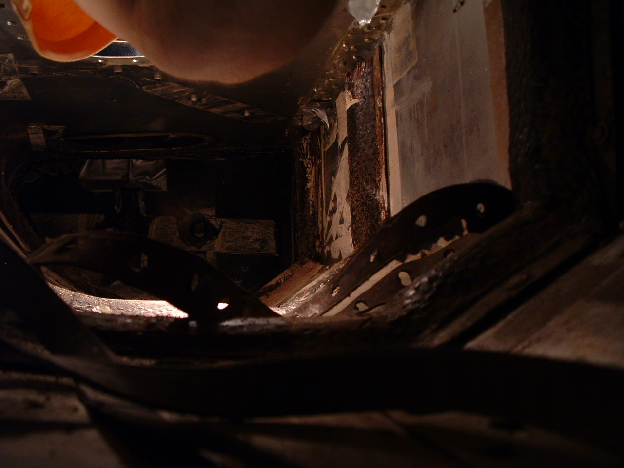

this is a shot inside the sponson, where the cell fits. I dropped the camera down through the fuel cell access hatch. The ribs are not rusty, they are covered in some sort of dried goo.Sorry for the fingers.

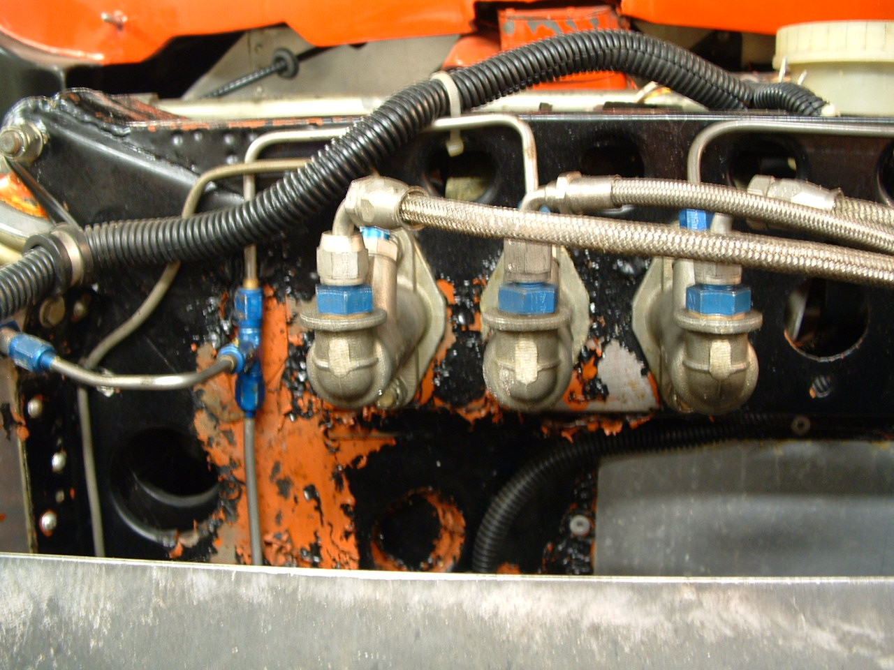

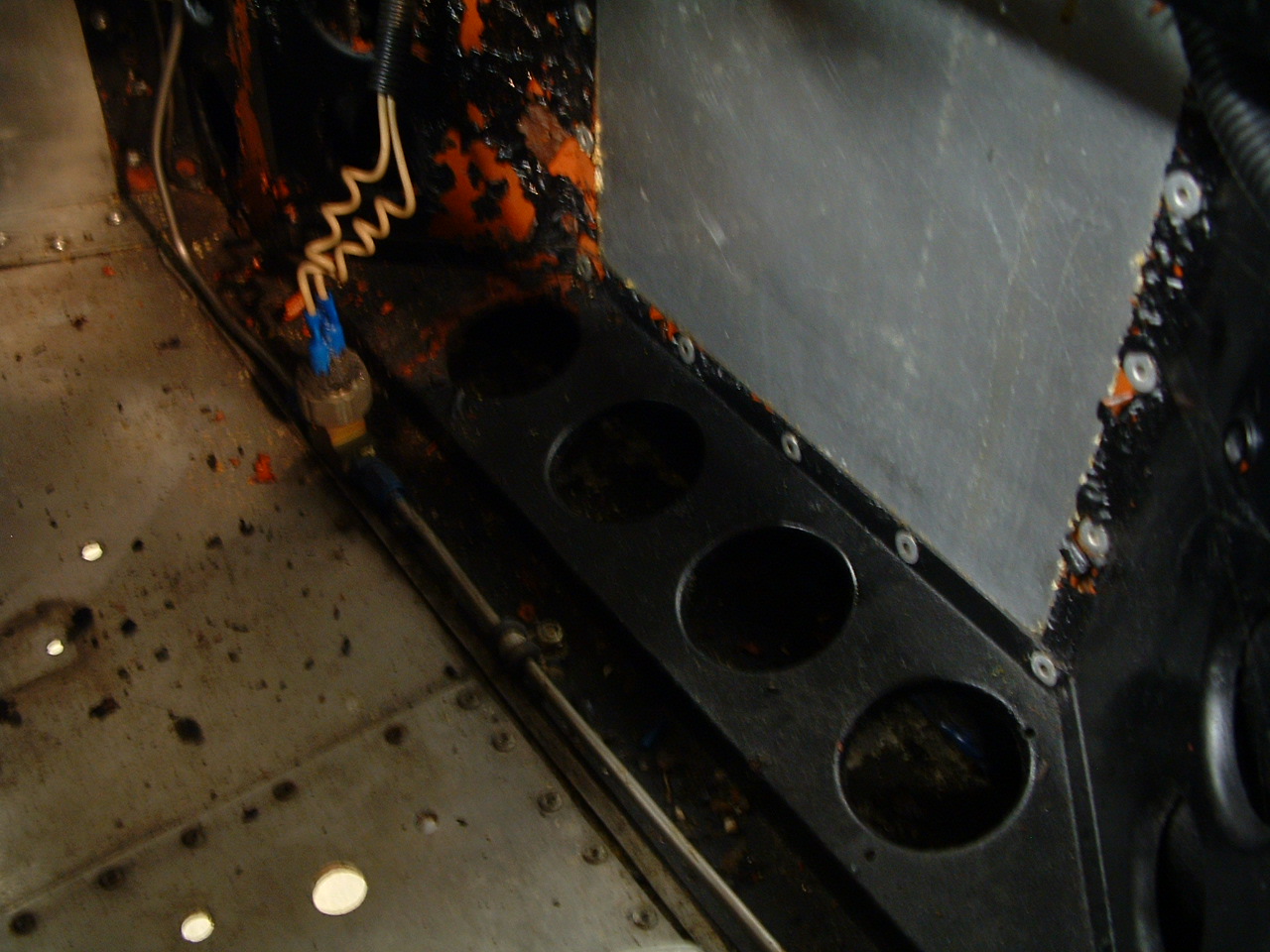

This is the front bulkhead where the fluids have been leaking out, lifting the paint.

The original master cyls were the small girling .70 for brake, .75 for clutch. They had the reservoir built-in, not remote. Those large reservoirs were added to coupes with the large calipers.
The brake line T fitting is usually at the top center of the bulkhead, not down low.
Racers usually cover the rivets inside the tub with tape to protect the cell. My cell is smooth since the tub didn't come with a cell. MKII and MKIII tubs had the fiberglass stiffeners inside plus some had snap in fittings to hold the bag in it's place. Later fuel bags used foam fillers so the snaps were done away with.

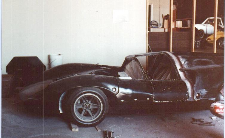

David, I have an extra MK I spyder windshield that I think I could copy and work with.It is fine but would need some modifcation. I can copy the general shape and then trim it to fit (I think).I have a rear section, but it is a MK I narrow job, not the wider one.I have some Can AM flair molds for the back that create the "half moon" vents behind the rear wheels.I can re-use the nose if I have to, but I do have a spare that might fit. I hope I can eventually round up the other body parts like the side pod covers and the "center section". I have NOT yet given up on finding the , or at least an, original body. I have identified the owner of the body shop (a Corvette restoration shop) that installed the coupe body , meaning the actual fiberglass bodywork and paint(22 coats of Gaurds red laquer-no clear coat), in 1981.He remembers the car and "may" have a body,but it is "not included or in usable condition".It is warped , too thin,incomplete, and cracked. Makes me CURIOUS just thinking about it.Interestingly, the name of the bodyman that did most of the fitting/work on the car back then is named "Jimmy Hendricks" vs. (Jimi Hendrix)!
