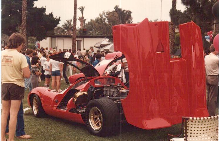

David, this is what the "Sunoco" car used to look like.
Also, I need a new left side fuel cell. It looks like a caterpiller, with indentations for the pod ribs.

Something looks different in the hub area of your ft wheel, I think it is the center hole is smaller size than I have seen. There should be a dust cap on there as well, mine were crome plated. some owners use a "Nylo" seal behind the nut and run without a cap.
The "correct" MKI wheels are 8" wide but the spokes do not taper closer together as they go outward to the rim, they stay parallel. Later wheels in 8" taper as in your photo, and the spokes run longer into the wheel rim like yours do. Yours look like the 8" wheels. There is a 9" spoke wheel like yours, the difference is, the spokes stop at the first point they meet the outer rim and do not continue down the side of the rim drop like the ones in your photo.
The Lola Wheels have been known to break, I saw one break on the front straight of Sears Point, CA, it broke in the rim lip area, the other one broke in mid-spoke, actually it cracked and was taken off the car. Several T-70 owners will not trust the original wheels and run copies, old Halibrands or Jongblood wheels.
On my car I have an original T-70 coupe wheel I can take a photo of if you want to see one. Supposedly the coupe wheels have a lip on the edge of the rim where a tire machine tool would rub. The Can-Am wheels seem to have just a raised lip there, but the coupes have a cuved lip similar to a steel wheel that you almost could attach a clip-on wheel weight to.

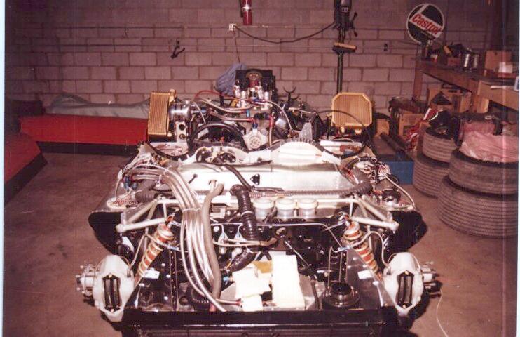

Here is the chassis from the last time it was restored. You can see the remnants of a roll bar. This picture was taken in november 1980 I believe.

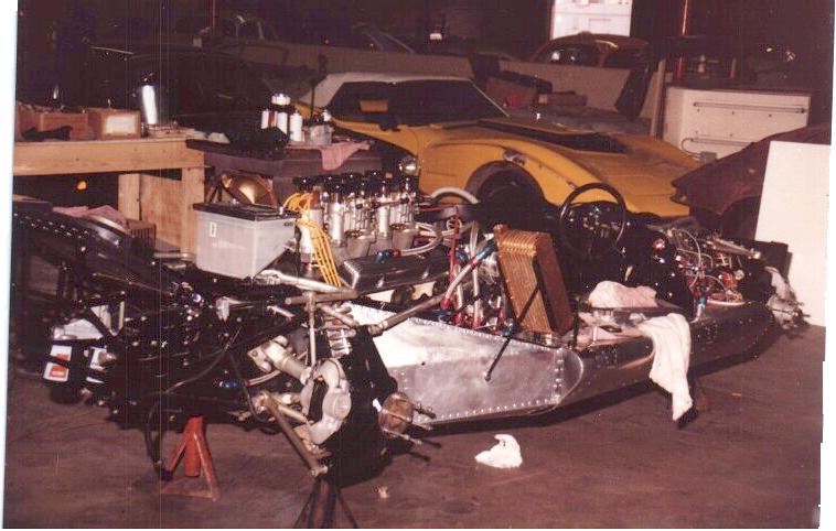

The picture above shows the car as it came, painted gray all over. It was restored and turned in to a coupe. Below is the progress of the restoration. I have to redo all this .
