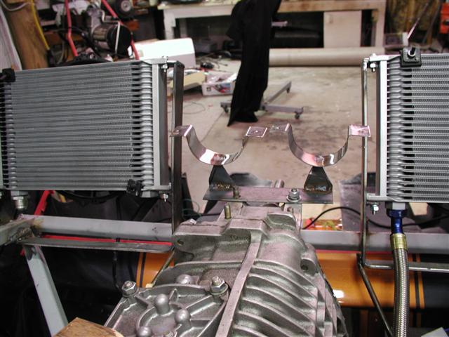

Okay, from all you guys have said, I think my best option is to fabricate a support piece that attaches to the transaxle and cradles the mufflers from below and uses springs to hold them down snug.

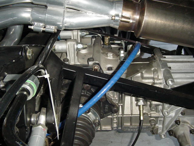

I've been trying to locate the sort of band clamps that were used in the photo posted above to clamp the primaries to the collectors. With singular lack of success. Does anyone know of a source for these?

It's tough to make out from the photo-- are the primary and collector pipes the same size and the sleve there to allign and seal the joint? Very sanitary look.
Here's a closer look John.

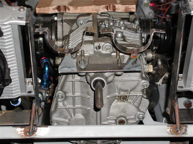

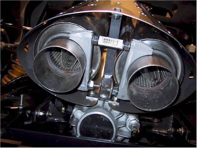

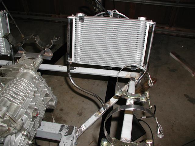

I orginally wanted to use the springs and started out with this arrangement in the first photo. After I got my mufflers, the shop guys showed me the stainless Tbolts and I have since changed my mind and am going to use the slip fit like Rich's on the front and attach the T bolts obtained from the mffler shop at the rear with a fabed bracket mounted like the one I started with on the inverted base. You can also use the Tbolts that have a base on them like the ones that come with the Accusump as seen in the side pic. Its all a matter of alignment. All shown here has been removed, cleaned up, and ceramic coated. Just awaitng reinstall. If you are going to use a heat shield there are lots of ways to do it. Here is one. I think it is Neals and is a neat arrangement.

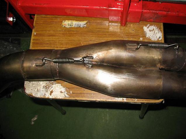

As the large GT40's member majority I am partisan to fixe exhaust pipes with springs. This mounting allow as well vibrations as dilatation movements to prevent any crack.
http://performanceweldingheaders.com/img/springtabkit.jpg
If you are using this kind of spring, don't forget to pass a safety wire as a loop inside the spring to secure it. This will avoid to lose a piece of spring in the track if for any reason the spring breakes ;)
