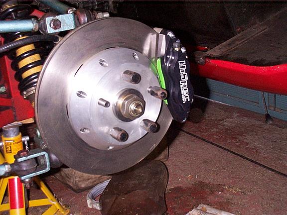

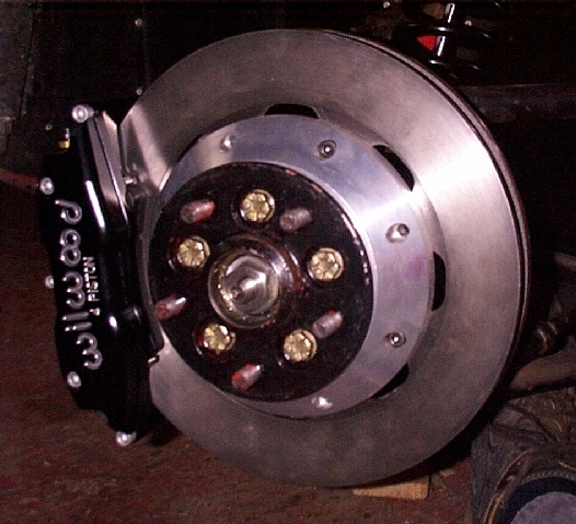

Hi H.J, Front Wilwood Superlite 4 Pot, rear, with Hispec Billet 4 all with 310mm (12.19 in) discs worked for me, no servos. I thought about 6 pots, but thought that that would definitely require servos due to the smaller total piston area. After having Servo issues I preferred to select for a servo-less system.
Dave

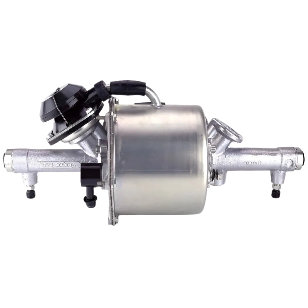

and then you have to consider two servos one for rear and one for front master cylinder Like this

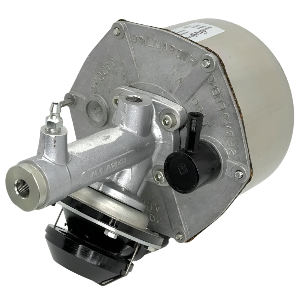

or one of the hybrid servos like this

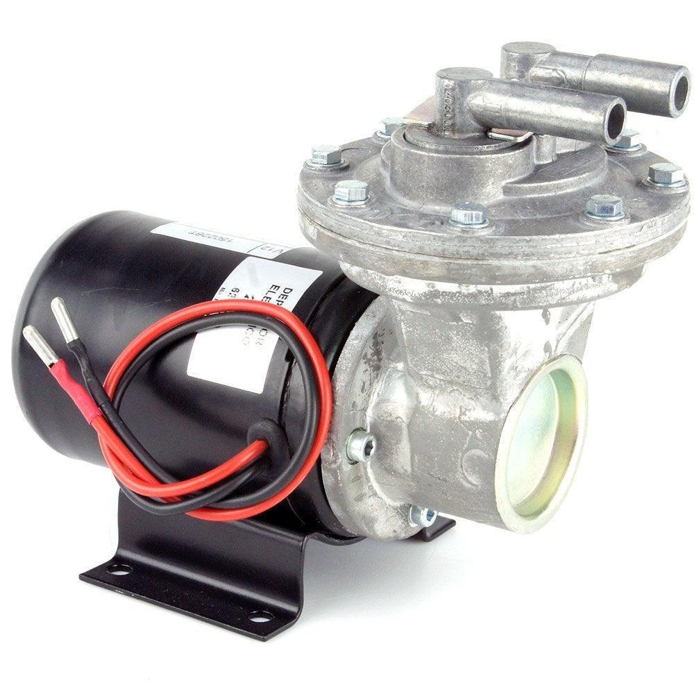

and if your engine has a big cam you may not get a good vacuum so then a vacuum pump too like this
it all adds to ££££ and weight and complexity, so if possible no servo and a decent pedal ratio
