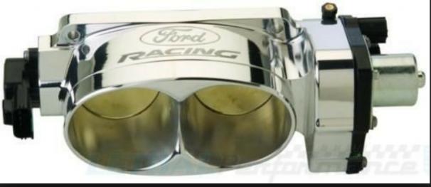

I have an oval (dual) throttle body that is 15.5" around and a breather neck at the other end that is 14" around and circular.
Anyone have any idea of where to get such a tube?Reinforced silicone would be best.
Photos may help explain a bit.

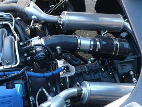

I thought it might be. It's a nice looking setup. Think i got this one off an an eBay listing but I don't recall for sure.
Parts are on order. 3" of 5" OD 6061 tube, a foot (more than I need...minimum order) of 4.5" OD, a 5" to 4.5" silicone coupler, a 5" silicone coupler, and various parts (venturi, filter, brackets, etc.) That came with the Cobra Jet cold air kit I ordered back in October and Ford just now released. It's gonna be tight getting the 5" ID silicone tube to foot around the oval throttle body (exactly 16" around) but the rest should be simple. Just drill a couple holes for the sensors, install them, slip on the couplers and tighten the clamps. No need for an angled silicone adapter as the throttle body is already angled downward at a near perfect angle unlike the stock one on the Coyote that angles upward. Apr the first break I caught on this thing so far. LOL
