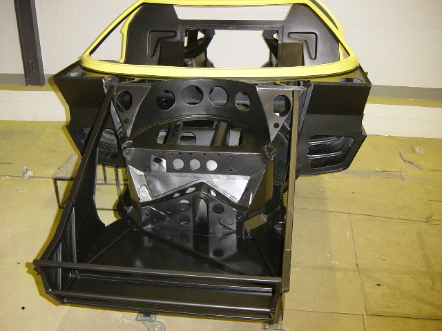

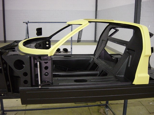

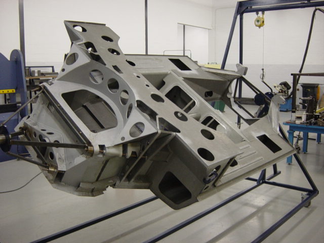

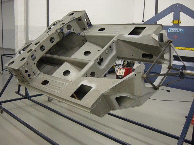

Hi All,
The following pics of the Superformance monocoque were posted a long time ago. In the meantime as many new members have joined I’m sure they would have missed out and I’m repeating.
As there have been many interesting discussions on the pros and cons of both space (tube) frame chassis and monocoques, the pics clearly illustrate the construction of a monocoque.
The Superformance monocoque, developed in the Cape Town factory, started off life with 257, if I remember correctly, laser cut flat panels, from large to small. These had to be pressed, bent, shaped, nibbled, drilled and finally spot welded together in a large cradle jig.
I would like to take this opportunity to give a message to would-be car builders, in particular in view of the RF saga. Unless your company is properly funded, has the right people and expertise. plant and equipment, don’t go into the business. Wishful thinking or dreams won’t make it happen, rather buy a McDonald’s franchise or make pine furniture or something less complicated.
I cannot stress enough that car building is an involved and complex business and it requires top management skills, vision, foresight and fancy footwork.

The roof/A and B post centre section is in fibreglass. The press tools for that section were subsequently made by Hi-Tech Automotive in Port Elizabeth and as I said before - MEGA BUCKS!

Quite right Andre, in fact the Safir built cars have a roof section that was hand formed on an English wheel and pieced together to the "B" pillars, etc. The original Ford/Abbey piece was larger and more complete but that takes a BIG press and proper matched die tooling. The Safir roofs were built by Brian Angliss as a subcontractor for Peter Thorpe when Safir was building chassis. Until one has really looked at the pieces that make up a '40 tub, the complexity does not register. Ford tooled this just like they were building a Falcon or a Cortina, as proper production tooling without regard for a cost/benefit ratio. Nowadays you can do steel pressings off urethane tooling and get several hundred sets of good dimensional parts but not thousands. But in 1963 there was steel tools for production or hardwood for prototypes. No CNC, laser or EDI machining to produce your dies, just a LOT of hand labor! /ubbthreads/images/graemlins/blush.gif
Makes the SPF tub eevn more impressive when you understand the quantity oan complexity of the tools involved....and then you have to weld it together! /ubbthreads/images/graemlins/wink.gif
