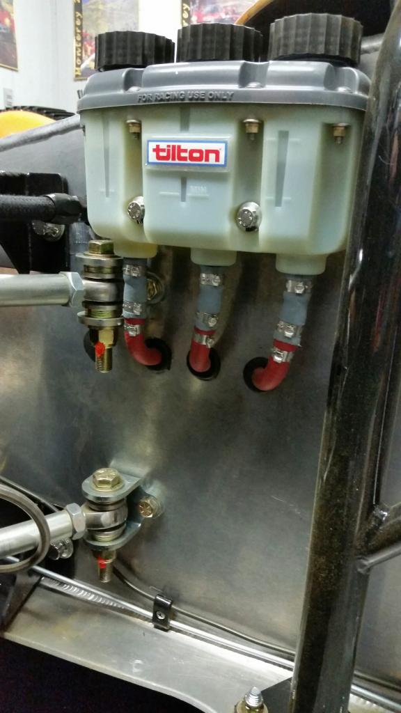

I used Tilton hoses to an adapter to the Wilwood hoses, then secured all the junctions with Oeteker clamps.
Dr. David
Ran across this photo and thought someone might be interested. I had sent it to a friend regarding the use of Oeteker clamps.
Illustrates the Tilton reservoir attached to the gray Tilton hoses, which are in turn adapted (via metal adapters) to the smaller red Wilwood hoses that go to the master cylinders.
If you haven't used Oeteker clamps, they are worth consideration.....very size-specific.
This is not an SLC, it is an LMP-1, and the reservoir is in the left fender well. I will cover the whole unit with a clear adhesive film that will allow for protection, a detection of leaks, and yet is easily removable and replaceable.
Just how I did it,
David

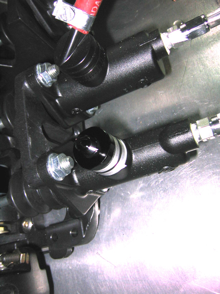

I've found a trick to mount a -3 AN nipple on the Wilwood masters. I can share details if anybody is interested.
So apparently Wilwood is quite aware of how poorly engineered their reservoir connectors are and have introduced some products to remedy that. This is a part I tracked down that is used in one of their upgrade reservoir kits but I was only interested in upgrading the master connection which is the weaker link in my opinion. It's a $10 adapter that screws to the inside of the master inlet and gives you a -3 AN:
https://www.summitracing.com/parts/wil-220-13130
You'll need to check your master cylinders however, some of the older ones aren't machined on the inside to accept this. In my case my 7/8" master cylinder was from older stock and didn't have it. If you haven't installed one of the older ones Willwood might do an upgrade for you, or you can just machine it yourself.
The trick to getting the reservoirs to seal apparently is to heat them in hot water just before installing them over the plastic connectors. It's a crappy design for sure but that method seems to have worked for me so far. No leaks since I installed it a year ago.
