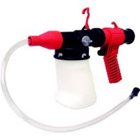

I use a vacuum device for a one man brake bleed -- no probs so far

I also used a manual vacuum bleeder ( MIGHTYVAC). it is cheap and works very well.
With this we bled the outside nipple first than the inside one. On a RCR both lines have the same lenght, but if you have one longer than the other, start with the longer side.
The mighty vac has a overflow cup. if you fill this overflow cup app 30%,the hose coming from the caliper will be submerged in brake fluid. The advantage of this is you dont need to open and close the nipple during bleeding, because if it sucks back, it will suck brake fluid no air.
So the action would be: Apply the vacuum, open the bleed nipple and than supporting the bleed action by slowly pumping the pedal. Also make sure that the feed line to your master is air free ( if they run in circles from the master to the reservoir it could be air trapped there. Wilwood masters can be bleed as well. Do this before you bleed the calipers.
