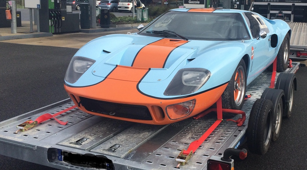

That's what I use, except my straps have the attachments that go directly into the e-track. Works good for low ground clearance and places where you don't want to hook onto the chassis or parts.
Thanks for the recommendations. Paul, your photo answers another question of mine (does the ratchet need to be inline with the other two hooks).

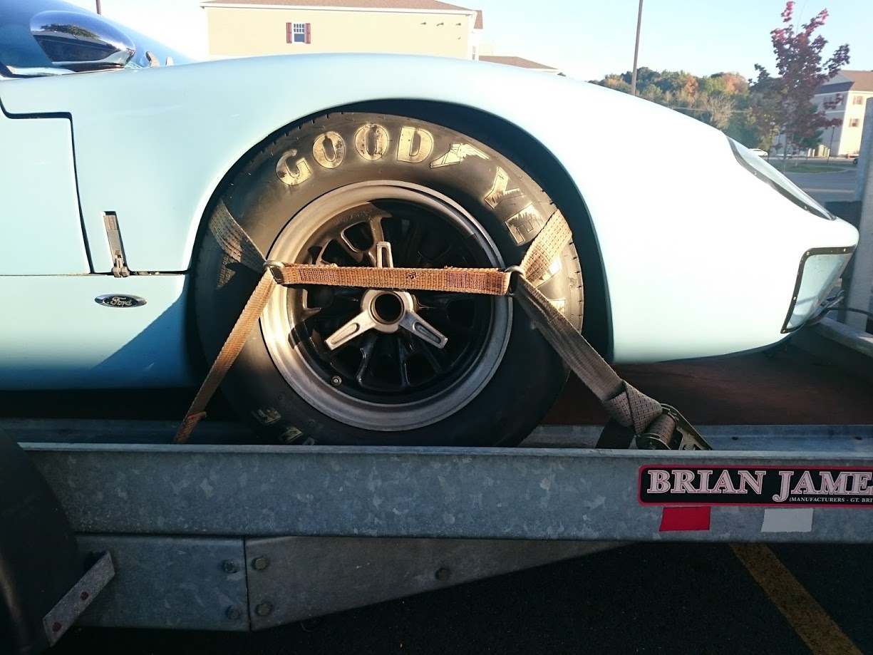

BTW, this is what I currently use. It's a combination of a single strap with something like an axle strap that wraps around the top third of the tire. It's easy to use as long as there's clearance for your hands.

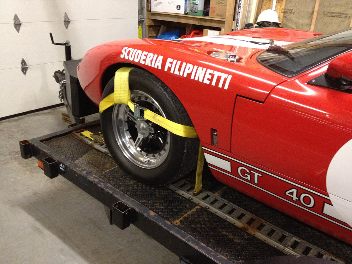

Ben, I would never use only an over-the-tire strap except for very short distances. We transported six cars in a transporter using those and after 3,000 miles (yes, a long trip), several of them had let go or come off. One of the cars only had one strap still holding properly. It scared the crap out of me. I only use the E-Track and the straps that go over AND around the tire. No issues yet.
