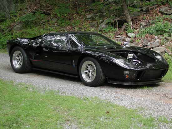

Have put the first 300 mls on the car. Went flawless. Did a trip to the SALZBURGRING. People where quite interessted. Have not put it on the track yet ( still waiting for my FIKSE Wheels and my SEMIS). Suspension is just roughly aligned yet, but still the car runs straight, is very light to steer and stays put during braking. Just trailed along the Autobahn at about 150 km/h, did once 240 km/h ( have my self impossed to a rev limit of 6000 RPM until the engine is run in).
Gearing is awsome, the change i did to first and second gear ratio is fully paying oút. THe engine runs strong and just blasts through the gears. Shifting is crisp and very exact. Clutch works great as well.
Here some pics in final trim

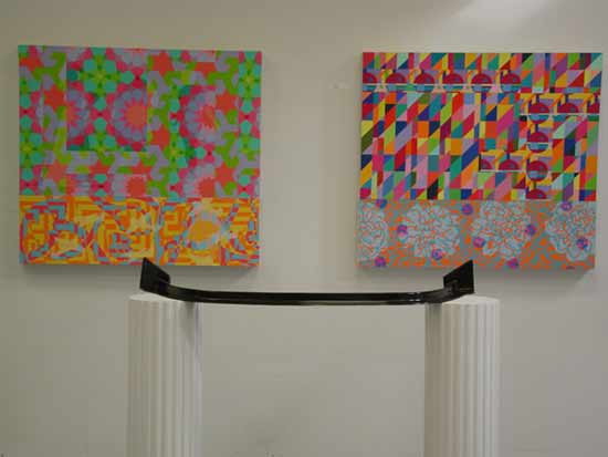

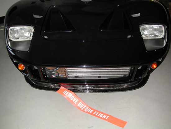

I´m looking for a small front splitter which used to be produced by XTREME CLASSIC.
THere website is gone. Any idea where they are ?
TOM
Unfortunately Mark, the owner of XTREME Classics, passed away a little over a year ago so I think the company is gone.
At one point CAV was building a splitter although I thought it was far larger than the XTREME version.
Kevin
Sorry to here that. Does anyone have still some pics of the Xtreme splitter ?
Agree that CAV PART is much to large.
THanks TOM
I cannot find any as it looks like nothing was saved to the site, all pictures were linked back to xtreame classics. There is a bunch of good aero discussion that Mark included in some of the threads from 2007.

Check here Tom;
Products - Aerodynamic Devices
In case the caching should go away I copied some images that I could capture here.
They wanted $850 USD for the splitter which I think is an outrageous price anyway...
