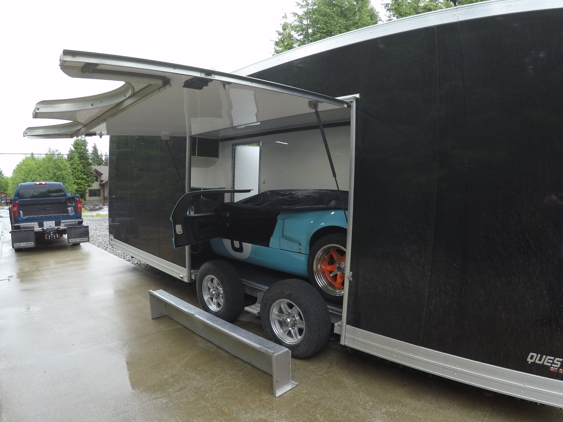

Thanks for the summary Howard. I too went with a 20 footer. Wanted the 24 footer, but I live on a cul-de-sac, with neighbors occasionally parking in the circle, so the 20 footer follows around the circle pretty well. Not sure I could handle anything longer in that tight area. I also installed a winch (crucial for loading the car, and just as important, a wireless remote for the winch. I built a platform for the winch that raised it about 18" so that I could either winch from the roll hoop, or if from the rear, the transaxle lower mount crossmember. That height for the winch eliminates any cable contact with any bodywork/windscreen in either loading direction.
You say the extra weight up front with the roll-away made a significant difference...assuming a good difference? I've built shelves for tools, a workbench, and various things to securely hold a jack, fuel, tools, etc, all at the very front of the trailer.
I can load the "Mc" either front or rear first. I am experimenting so far on the last few trips with the car's CG a few inches forward of the wheel-pair centerline. With all the added weight up front, I'm thinking this may be the best position for the car. Front loaded gives me room front and rear, rear loaded, the nose is just inches away from the rear door.
Tie-downs: I went with E-track, with swivels at each wheel (strap goes over wheel, through the swivel, and then forward/rearward to the E-ratchet. I installed E-track at the top of the trailer (using 2x4 stud brackets) to allow flexibility in overhead racks/shelves that run across the entire width of the trailer, as well as just above the highest point of the car for the same if needed. I also utilize the E-chocks, which give me a "set" stop so that the car is loaded and strapped down at the same place each time.
Wheel chocks: I am impressed with the scissor type of wheel chocks that fits between the pair of tires, then scissor out to push against both tires. My driveway has about a 10% incline, and these scissor-chocks hold the trailer in place very well.
Interior lighting: Lastly, I purchase a lot of cheap LED lights for the interior. I doubled them up for the workbench, and have found they work very well, and light the entire trailer well on about 2 amps draw.
Lastly, as much as I did not want to deal with any portable ramps, I still had to go with a pair, even with the dove-tail trailer. These are a simple affair of two layers of 2x12 lumber, stepped to raise the edge of the rear door by 3" over a 5' span. That ended any issues with scrapping the nose when loading. These are stored vertically using E-track at chest level (the track just above the highest point of the car.

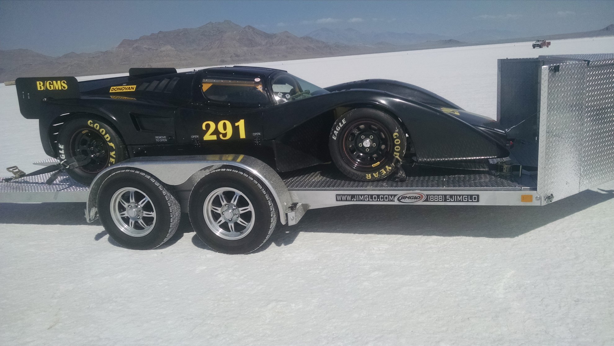

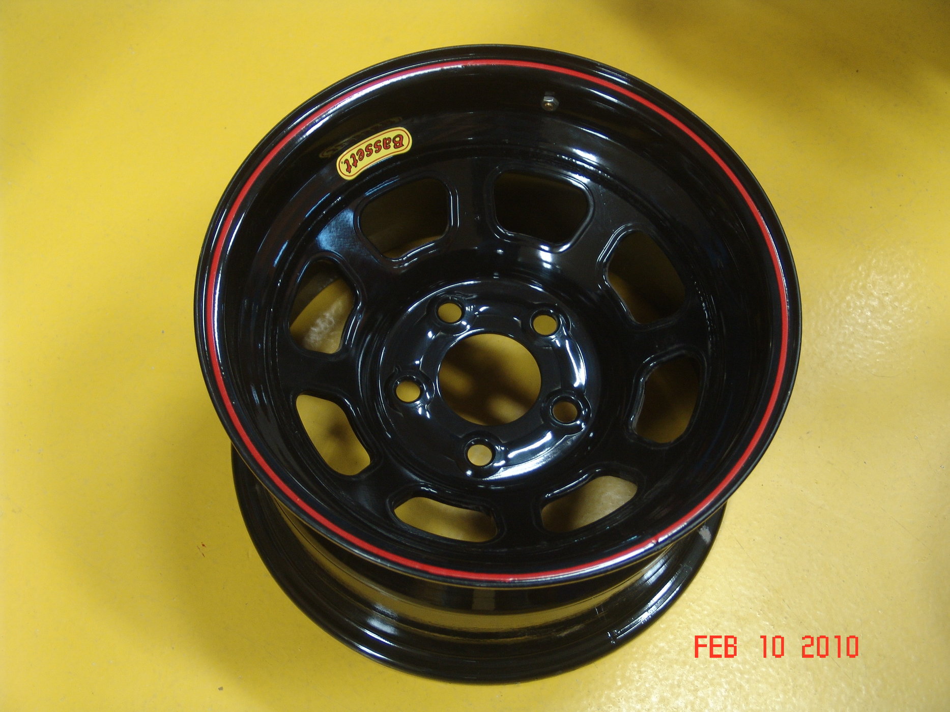

I use through-the-wheel straps to secure all four wheels of my car on my Jimglo tilt trailer. The nylon straps feed through slots in Bassett wheels. Once the straps are tightened the car is secure; I leave the transaxle in gear while transporting. A word of warning, though- don't use Harbor Freight ratchet straps if you value your car.

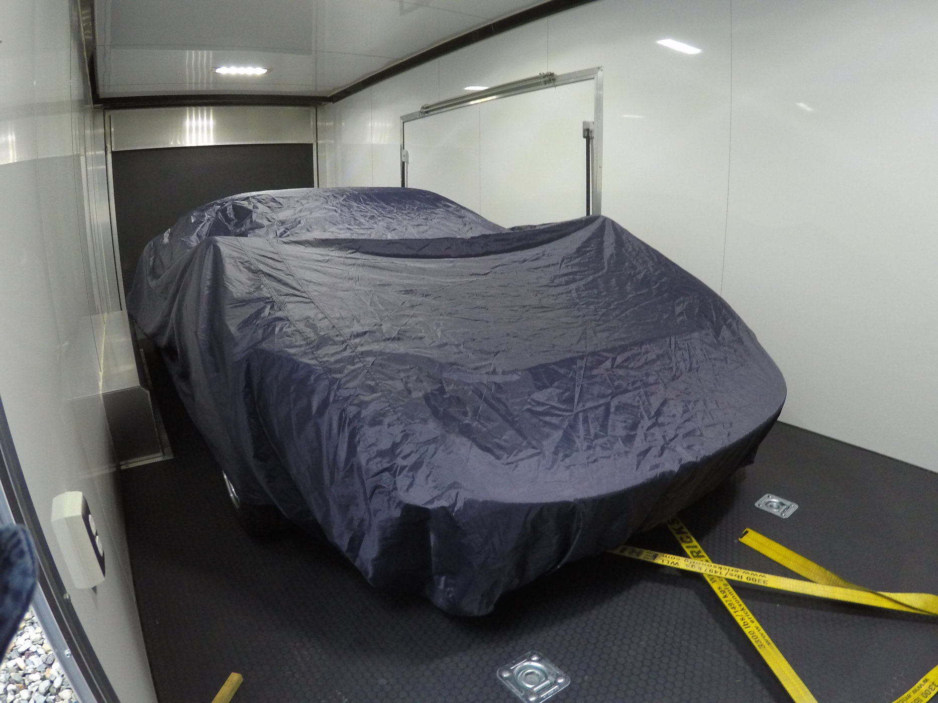

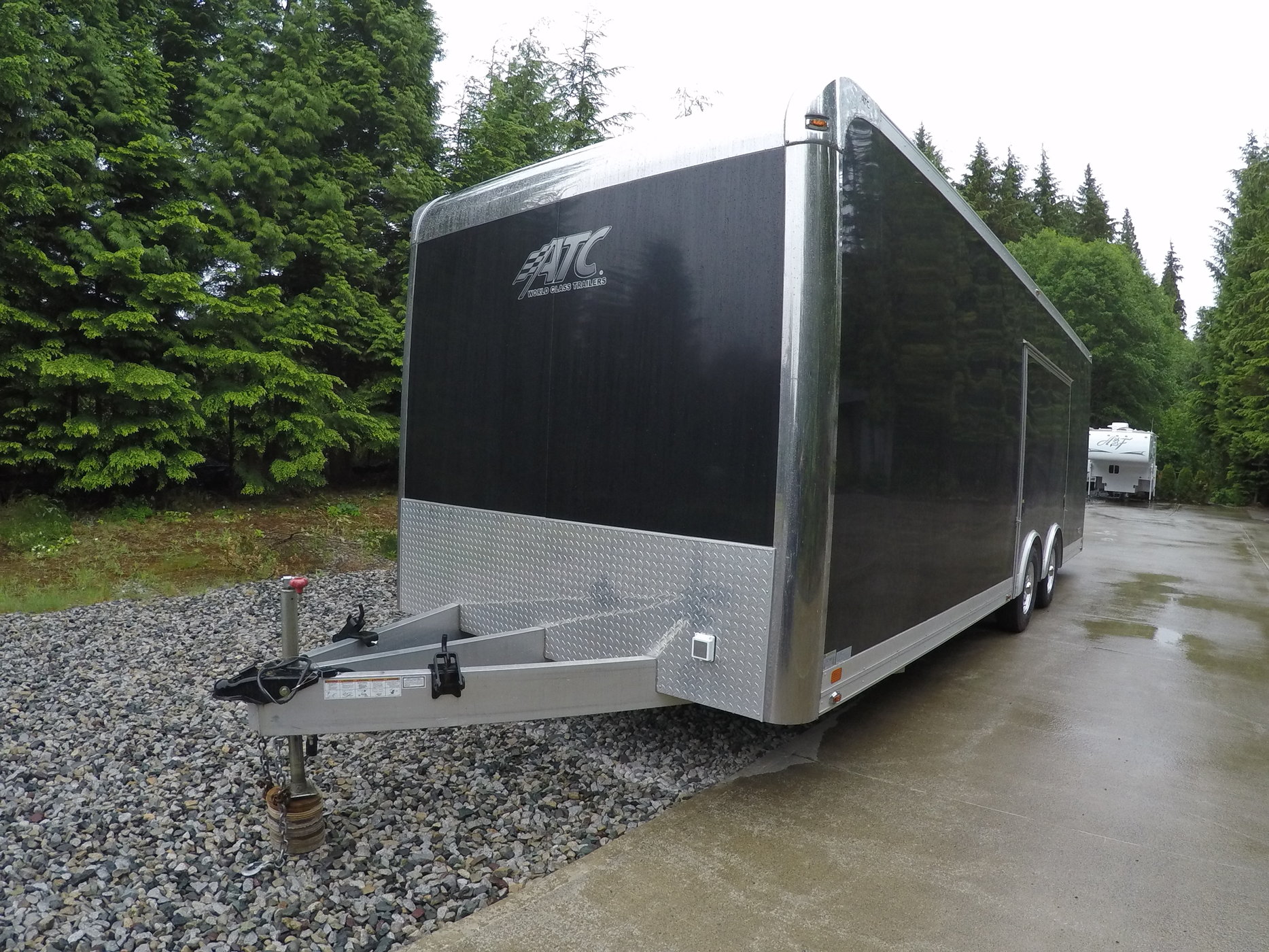

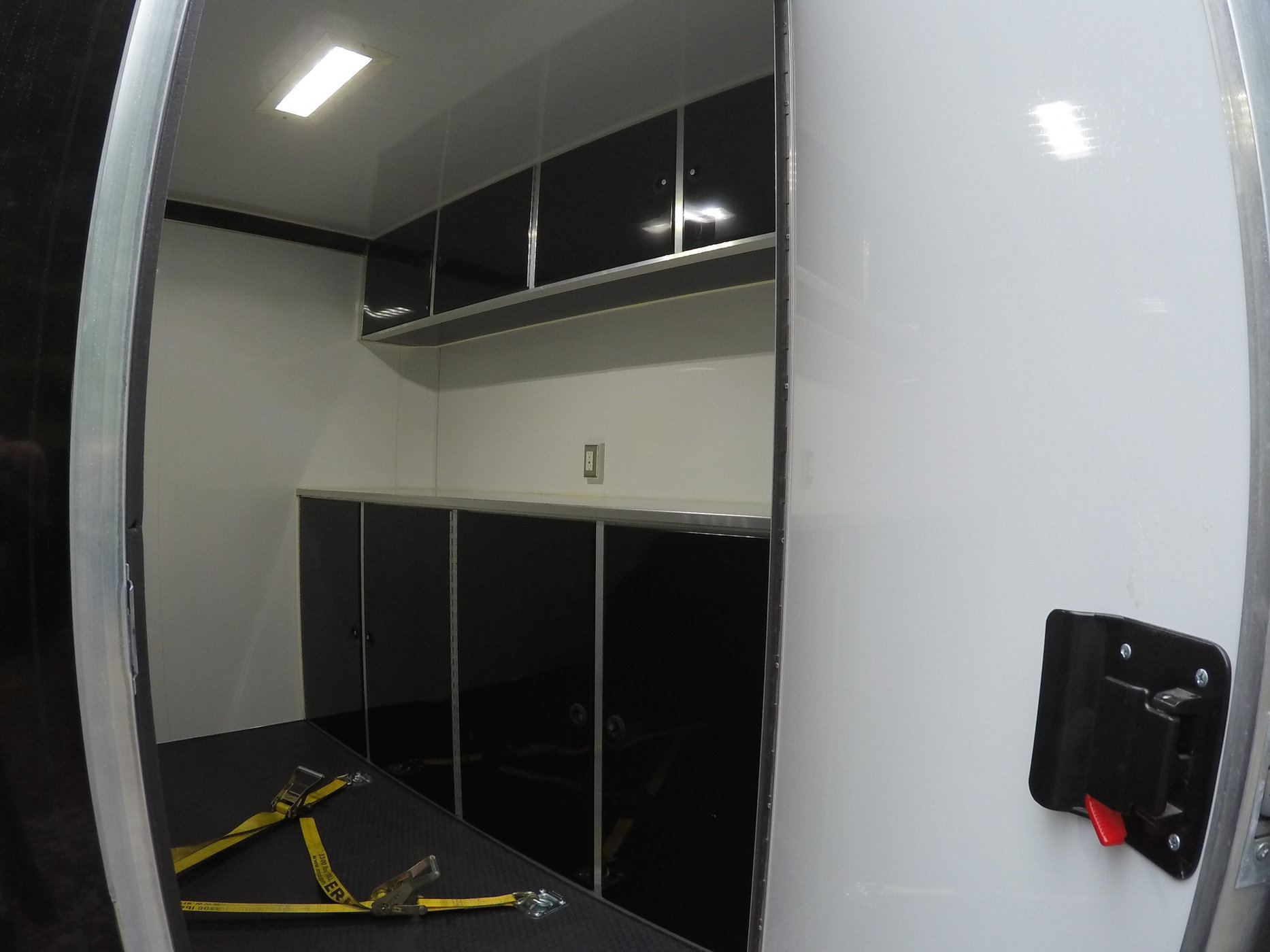

I think I have the best of the bunch, bang for the buck. A 24 foot ATC with a side door, cabinets and I also installed a 4000# winch.
I use the winch when loading only. The side door is about 7 feet wide and opens up as a sun/rain shade and allows you to open the car door, lots of room. I strap the tub to the floor. Check on things at coffee and p brakes. I'm of on a 2500 mile road trip in the AM.

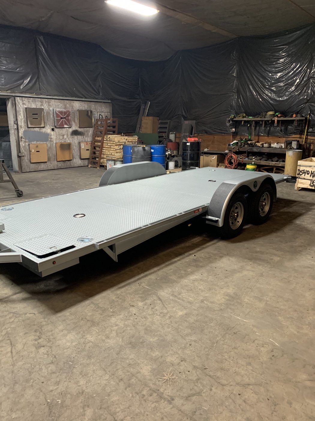

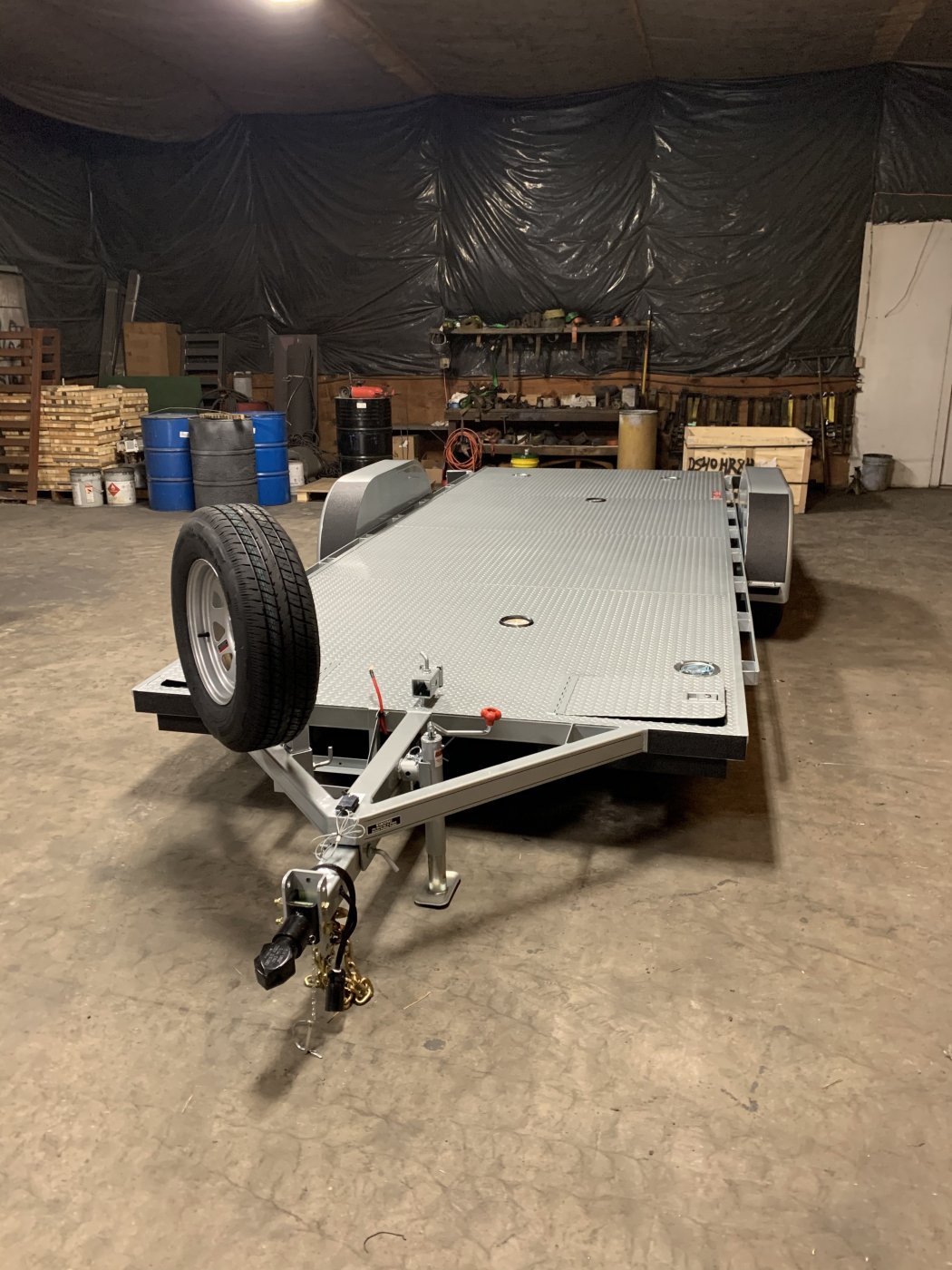

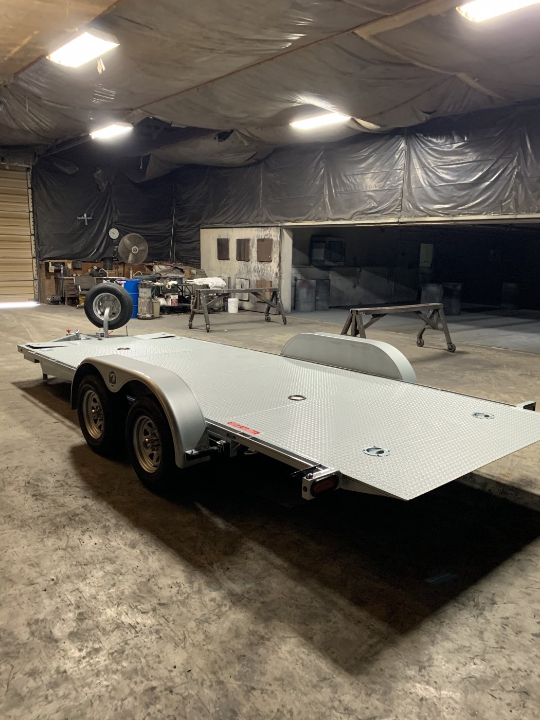

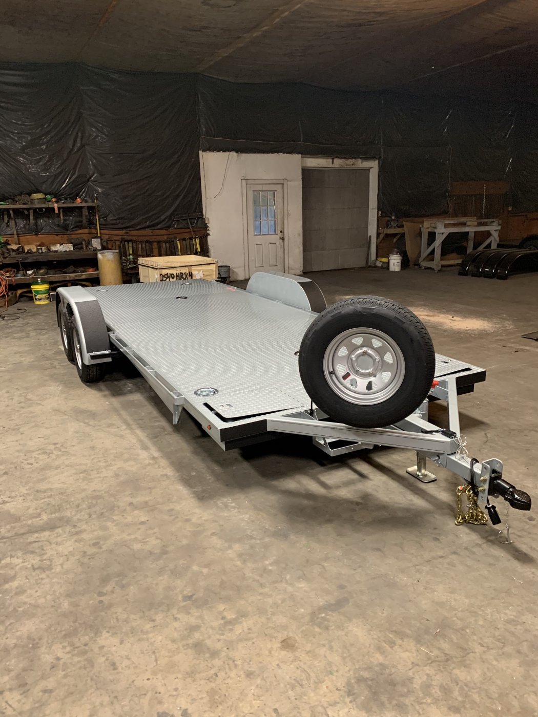

Just bought a Kwik-Load texas rollback. Will be here Wednesday and then I can post more.
18’. Winch ready. 5 degree load angle.
Loading Deck: 78″ Wide, 84″ Between Fenders – 1/8″ Steel Diamond Plate
Load Capacity: 7,000 GVWR
Tie Downs: Four 6,000 lb. swivel “D” hooks
Frame: 11 GA. 3×2 and 3/16″ 3×3 tubular
Axles: Twin 3,500 lb. drop Torflex with Easy Lube
Coupler: 7,000 lb. capacity with safety chains, brake-a-way switch and 5,000 lb. swivel jack
Brakes: Four-wheel electric with manual parking brake
Wheels: 14″ Silver Mod Wheels
Tires: New 14″ 6-ply radials
Lights: Twin tail lights and side markers with two lights in bed for loading at night
Fenders: Two removable with Chip Guard
