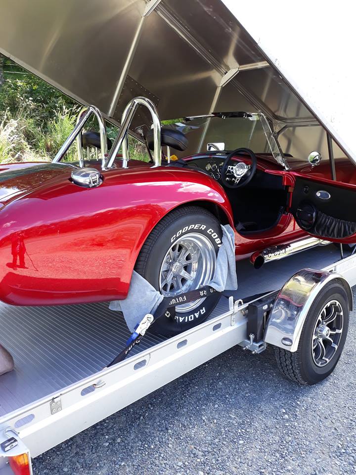

Ive a cobber with a single axle version of these, has his Cobra in it under a alloy top cover that works off the trailer hydraulics, no doors etc, just cover operated by hyd rams etc, have a pic somewhere, a bit on the $$$ side but all he needs, GT40 loaded backwards would work fine & these trailers have one of the lowest deck angles around and best of all you wouldnt know there is a car inside.. Ill have a look for his pics & add later if I find em.
