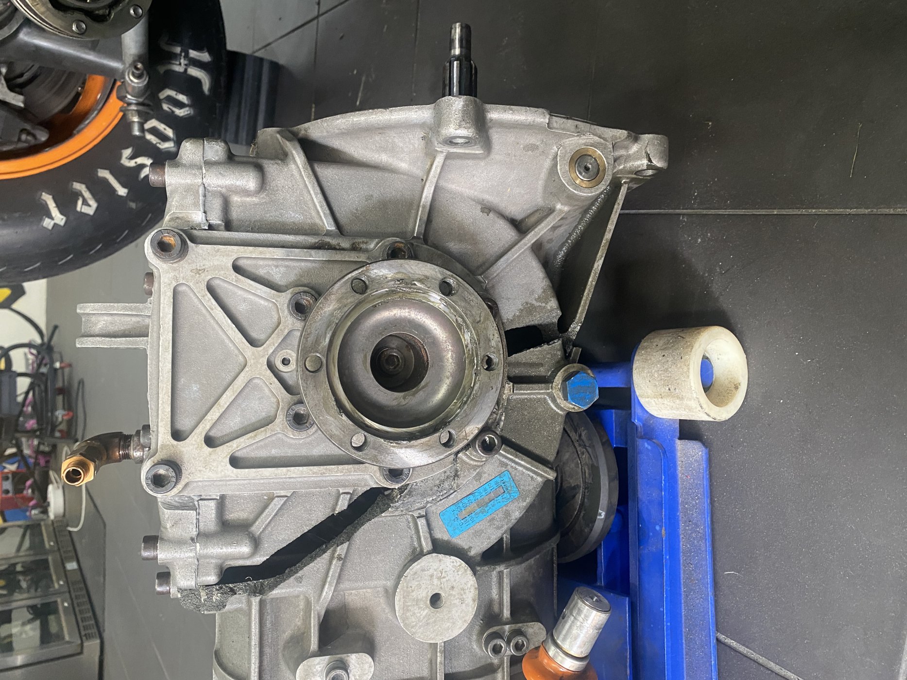

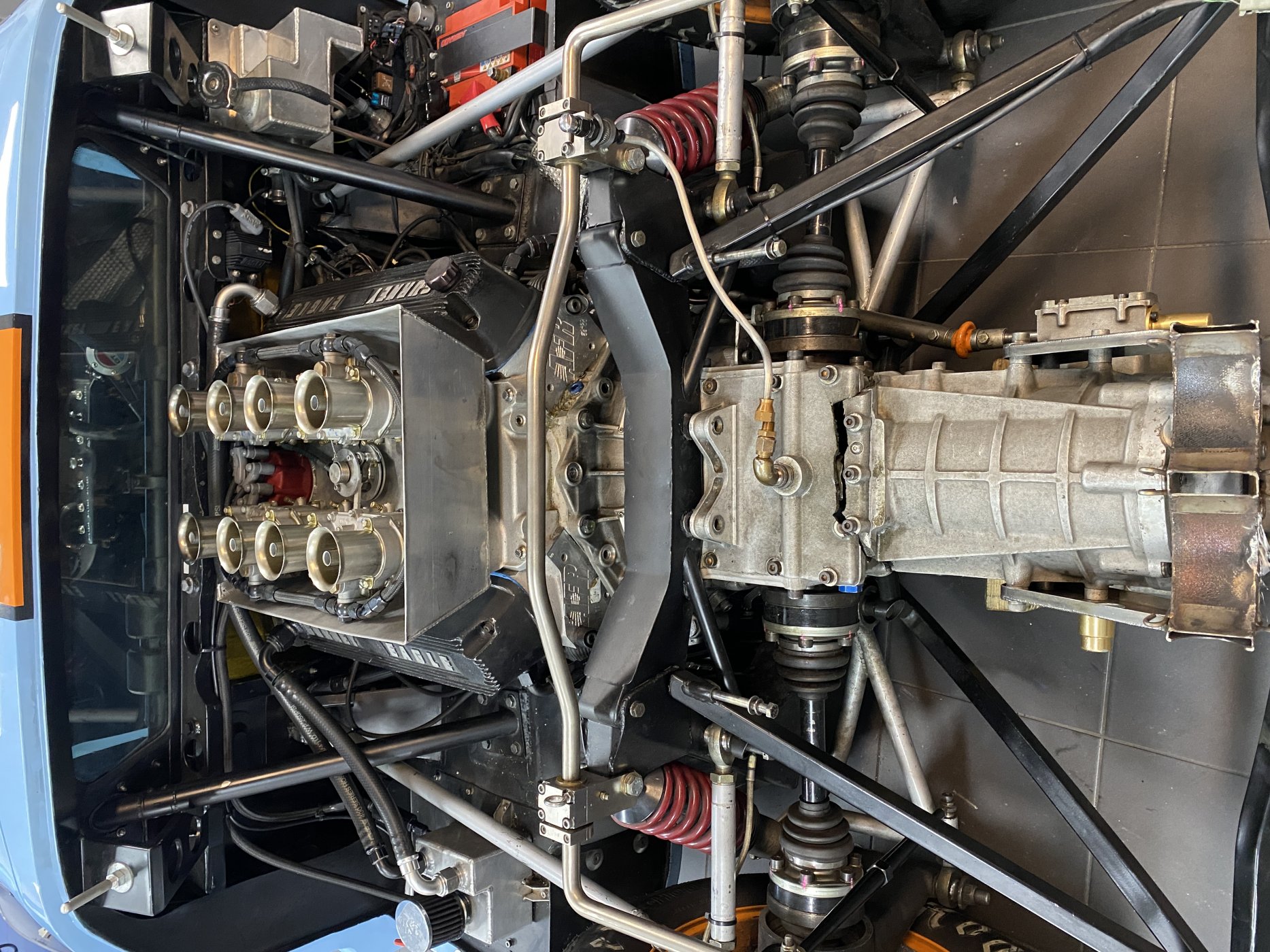

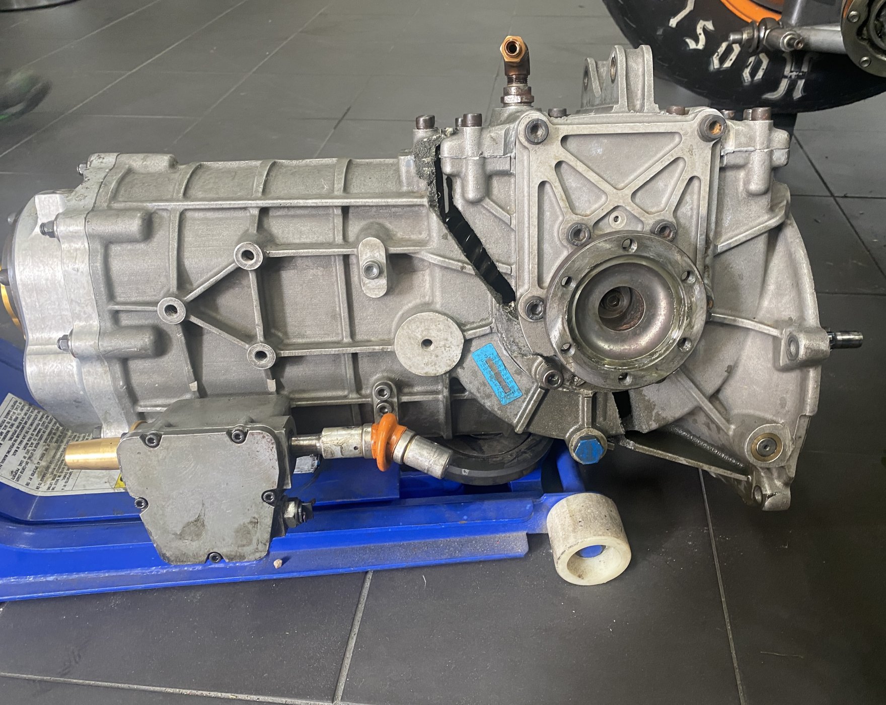

From experience my engine was built 566bhp, 540ft/lb, it destroyed the ZFQ 3 times. I had the engine rebuilt to match the Gelscoe 302, 495 bhp 420 ft/lb. Even with careful heel and toe etc the synchros need serviced every year. This year I had the gearbox serviced, then the CV carrier bearing fell apart and blew the diff. The diff was rebuilt then the case broke in half. Olthoff Racing have had a lot of experience in both RBT and ZFQ with a lot of problems. I’m waiting to see what to do.
