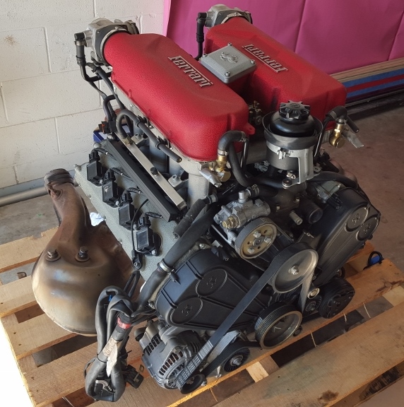

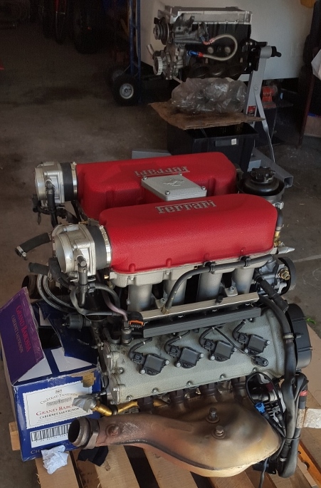

The new engine is home, and now the real fun starts. I still want to reinstall the V6 in the Ralt to ensure all systems not related to the power unit are fully operational.
I like the engineering behind this V8, it's such a shame to pull that intake manifold off. It features dual length runners, with ITB's inside each plenum that open at a pre-determined RPM to significantly reduce the runner length for top end breathing.

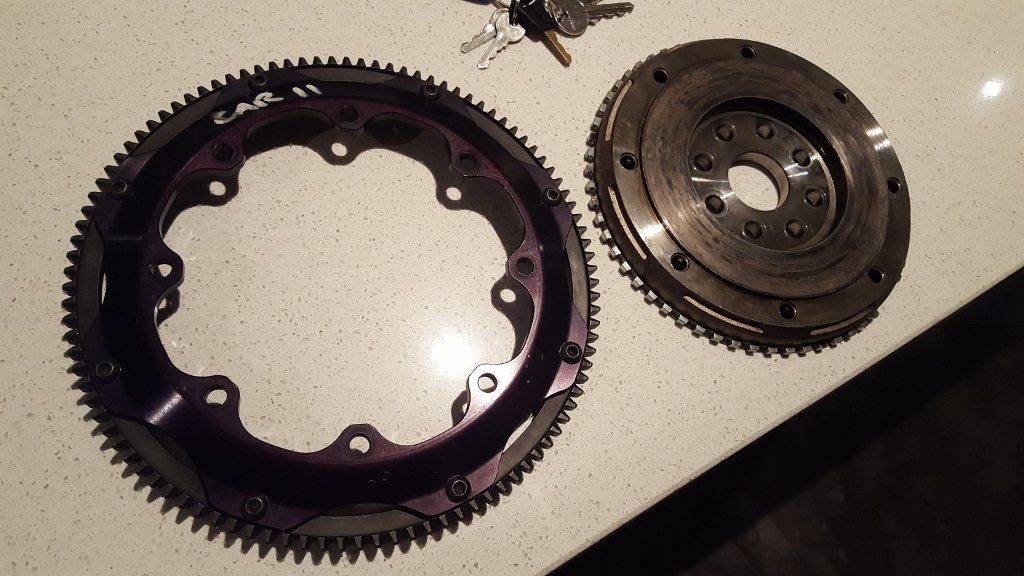

As for the F motor, I'm down in Melbourne with the guys at Maranello Motorsport playing part-guys with some amazing toys. I only have good things to say about them there - very professional and yet nice guys too. Turns out that the Ferrari 458 has the same flywheel bolt pattern, and that the race version of that car (458 GT3 - pictured) has a flywheel similar in size to the Ralt, has the same 60-2 crank trigger as a stock Ferrari 360, and the same mounting PCD for the clutch so I can still use my AP Racing 5.5" clutch. The ring gear mounts to the back end of the clutch basket.
The flywheel measures just 180mm across.
Next on the list is an adapter plate and starter mount to make all this work (I got the hard part done Flatchat!)

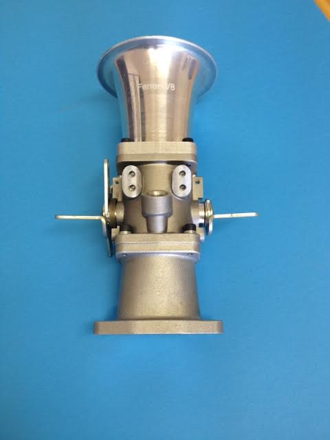

I'm piecing together an 8 stack set up for the F motor with these 48mm diameter Jenvey TB's and cast runners. I want to plumb in a balance pipe between each inlet runner for each bank, but want some advice on the size that it should be.
Suggestions appreciated.
