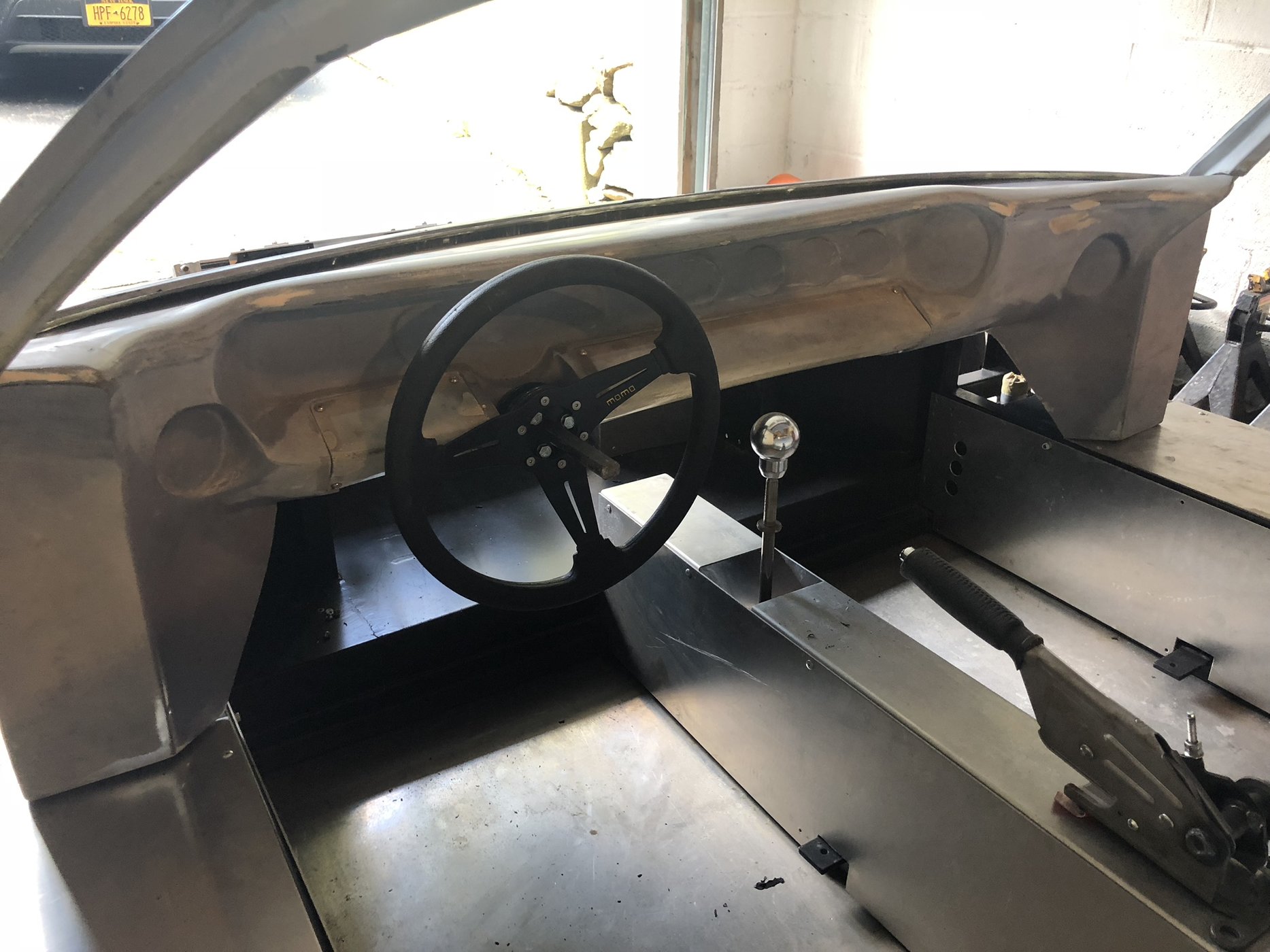

Hi Steve, from your picture I noticed you mounted your parking brake. If fully installed, could you send me pictures so I can have an idea on how to install mine. Thank you

Check my build site, look at the steering wheel. I'm in a spot as well. I would like a contact/brush of some sort to work with the quick rel steering wheel. A button I can hold down to ground a signal as ness. So far the easy fix is a self centering switch but at the same time have my right hand available for the shifter.
Hi George, unfortunately it’s just sitting there. I have some ideas and I’ve fabricated a bracket but I’m not happy with it. I have to go back to the drawing board.
Beautiful work. I’m an amateur doing my first build. I may just go with a toggle. It might be the best solution.

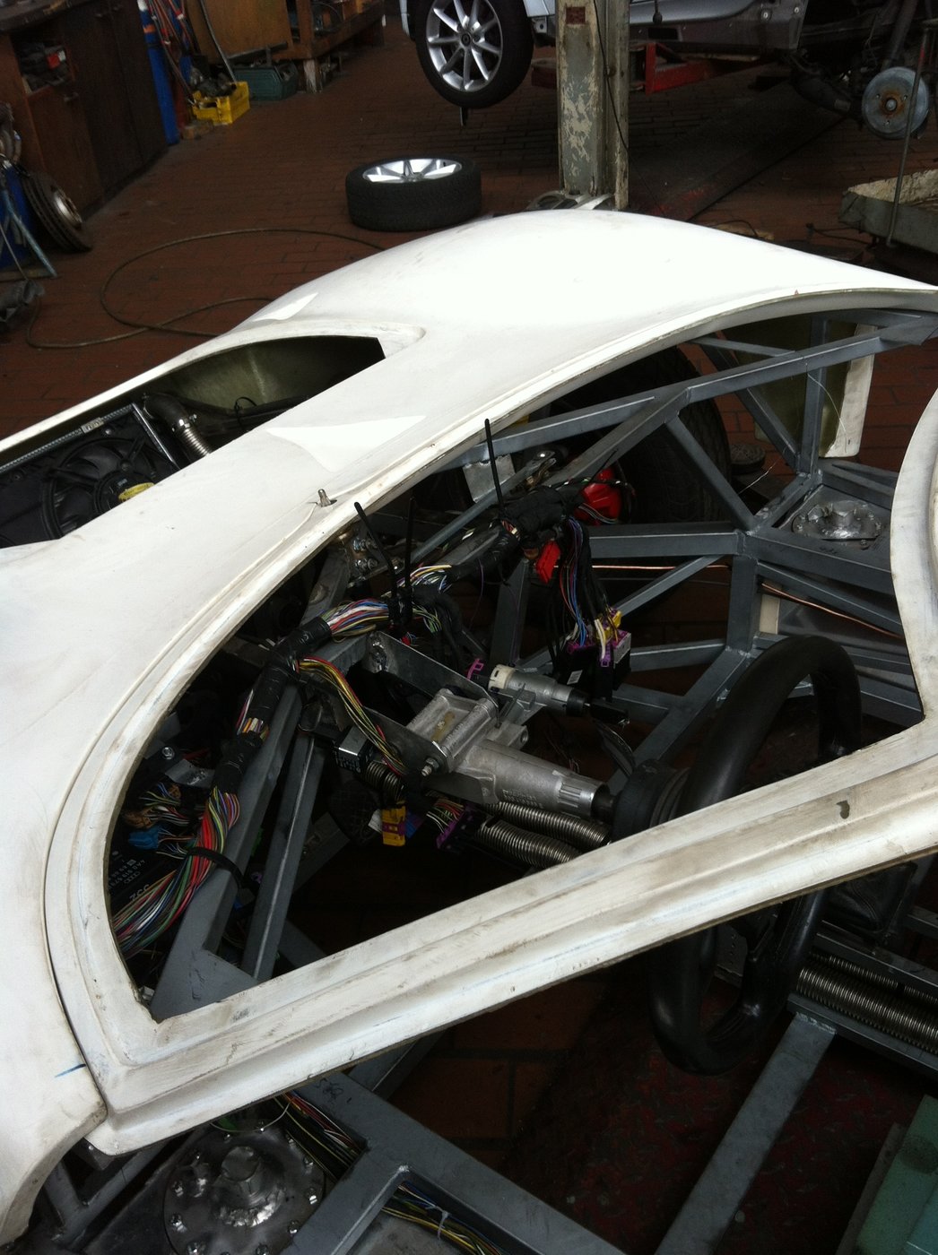

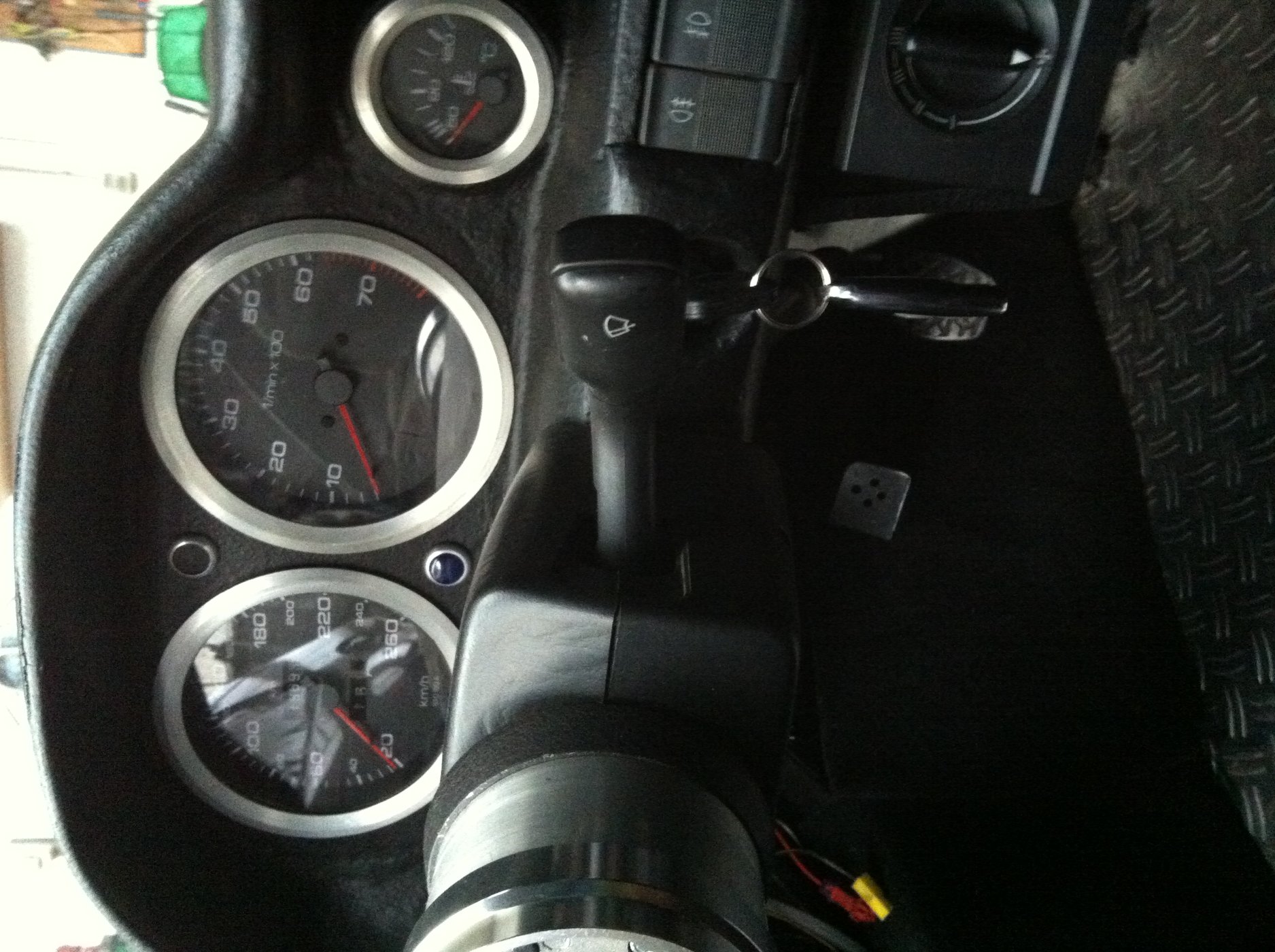

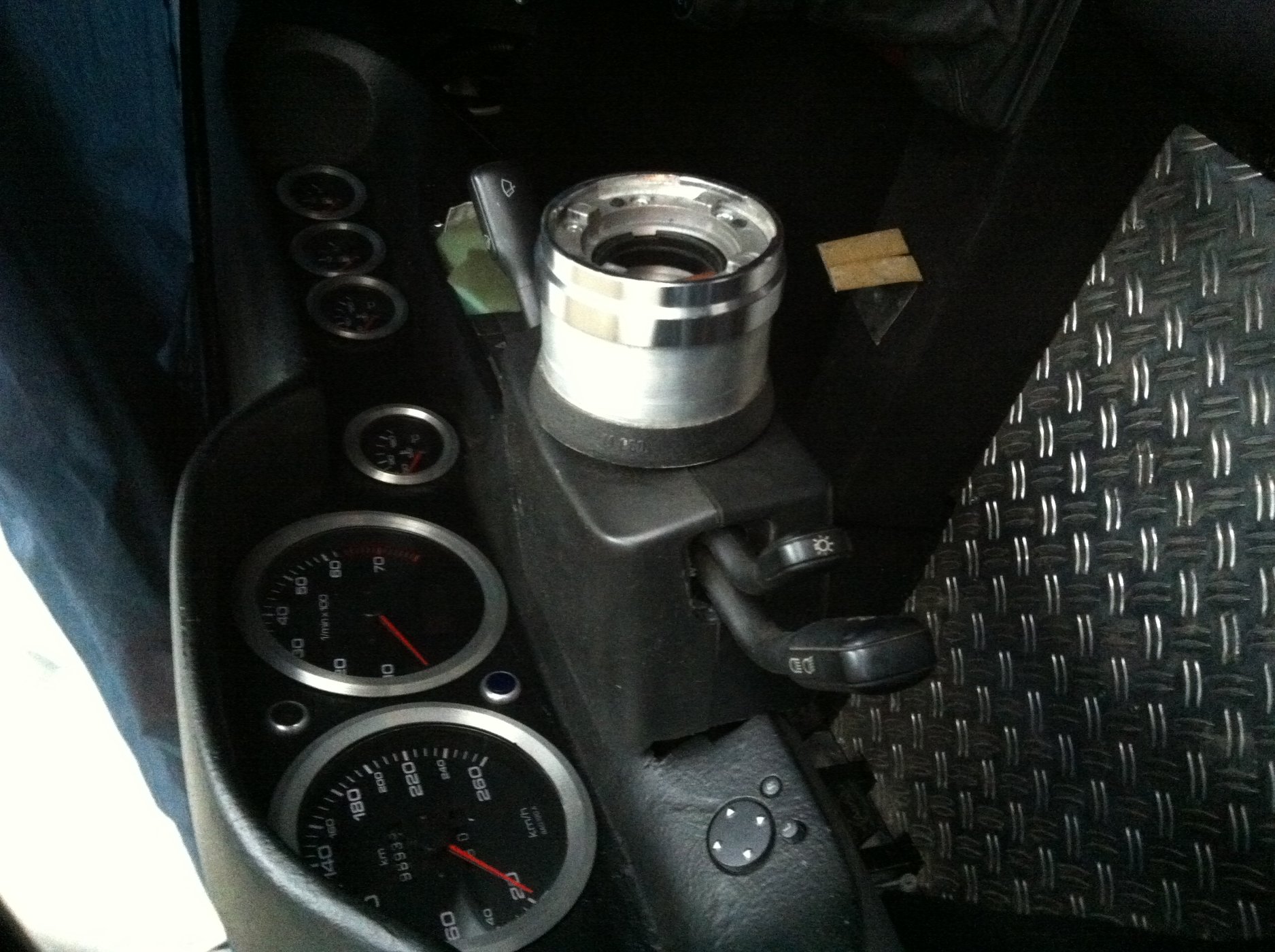

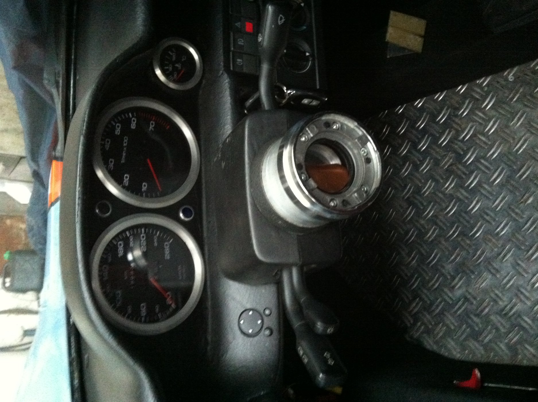

h ich habe benutz Schalter Einheit von Audi 80 model 89 da ist Alles was mann braucht und Zündschloss auch passt alles gut zusammen, ich kann dir bild schicken sorry, ich spreche nicht englisch george

hi hie sin die Bilder
