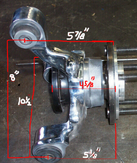

I don't know what the differences
are I will post the dimensions of our set up and maybe some one this form can tell us what they are I know if you run the 13" rotor, that you have to use a 16" or larger wheel
dimension

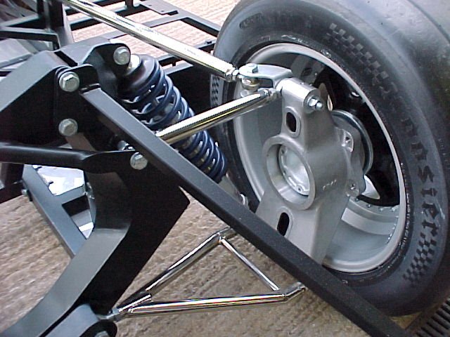

The best combo looks like T-bird/ Mark 8 rear uprights, and Wilwood Mustang 2/Pintos for the front (with the 2" drop option). This combo seems like the best option for donor uprights. The Wilwoods especially are very flexible- can be front or rear steer, you can use any of 3 different wilwood disc sizes, and go 4 or 6 piston calipers.
I'm just wondering if there are any other donors to take a close look at that anyone could add? If anyone has another combination of donor uprights to consider, would love to take a look before I start buying parts.
Also, I wasn't able to find a good photo of the T-bird rears mounted-up to a car. Just curious on how people have packaged these, in case anyone has a photo...
