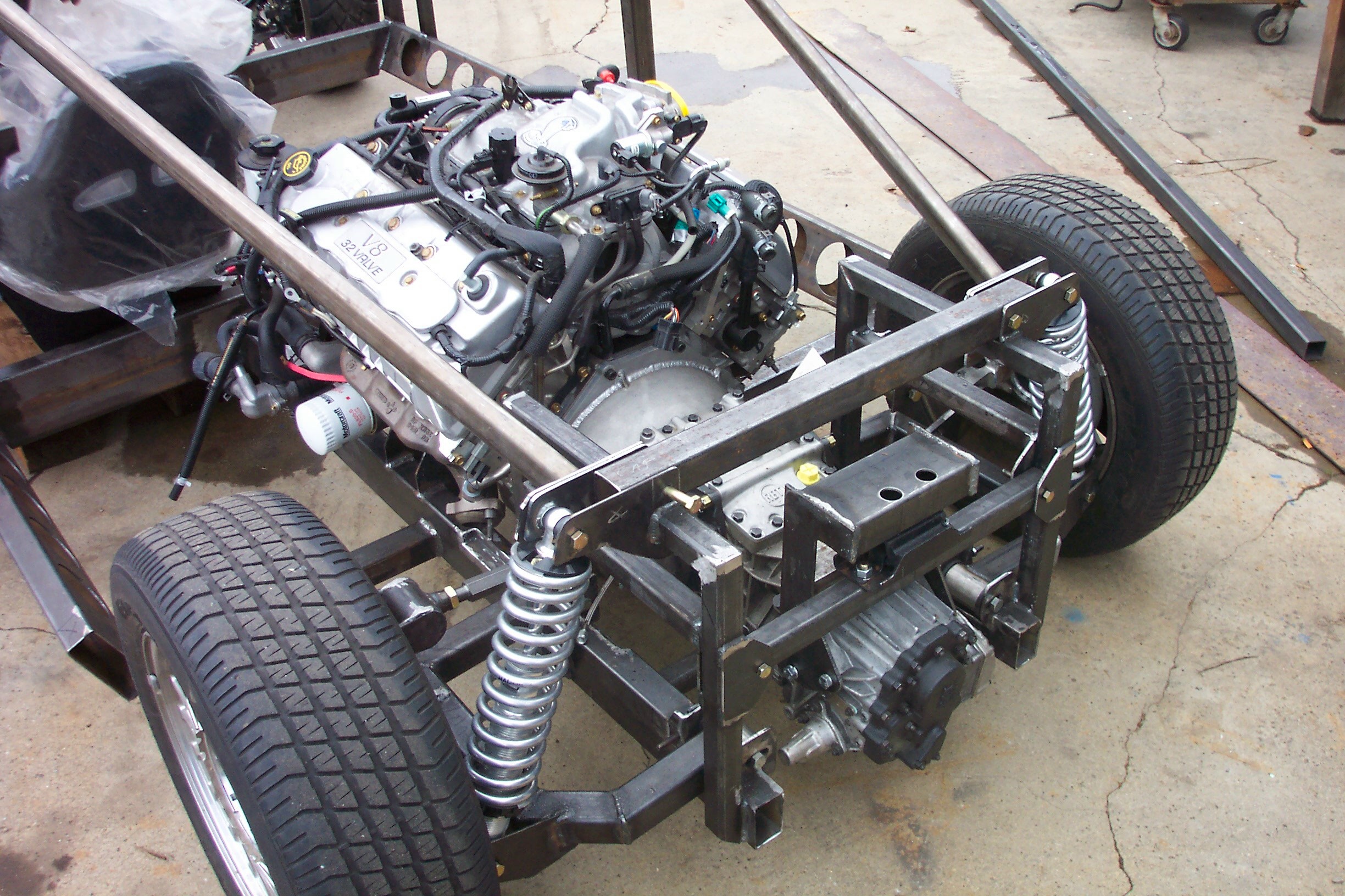

Chris Ford has a complete package for the 4.6 it is a retro fit for earlier mustangs We have the parts you will need to mate it to the tyranny

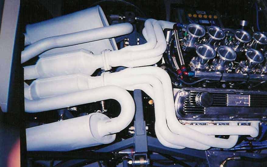

Chris,
RF has built a few with all of the smog requirments. OBD II
systems are available as well. I believe the Australian ADR's are tougher than most American States.
