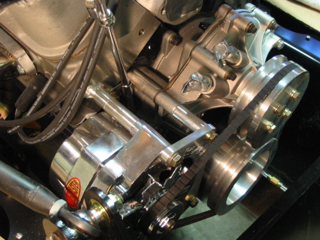

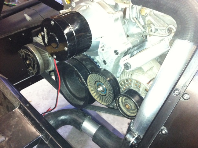

Found some pictures showing the current set up.
Just finished playing to solve the same problem.
Rich E.s on the money. The contact area of the 6 rib belt is more than adequate for the apparent lack of wrap-around on the crank pulley.
Clive
