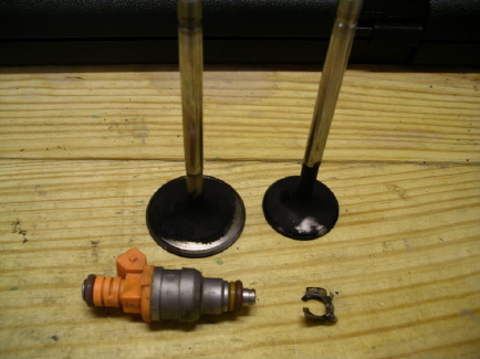

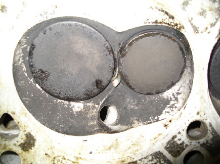

Easter Sunday: I started the car up for a car show and heard a rattle. Come to find out, the cap was missing from the injector and had gone into the cylinder. I informed Python customer service shortly thereafter, and spent weeks trying to come up with an 'easy' solution. Finally bit the bullet, and scheduled (another 4 weeks) the engine builder to pull the head. With 30+ years of experience, he (Matt Johnson's, St. Louis) said he'd never seen anything like it. Turned out the plastic conical cap had split into a 'U' shaped piece and become jammed with one leg of the U in the intake port and one leg in the exhaust (hence not blowing out the exhaust). Both valves (Ferrea stainless) had to be replaced.
See attached pics.

Perhaps this rather expensive and time consuming lesson will be helpful to those of you with DFI. Inspect the plastic caps on your injectors veerrryyy carefully, or better yet, buy injectors withOUT pintle caps.
