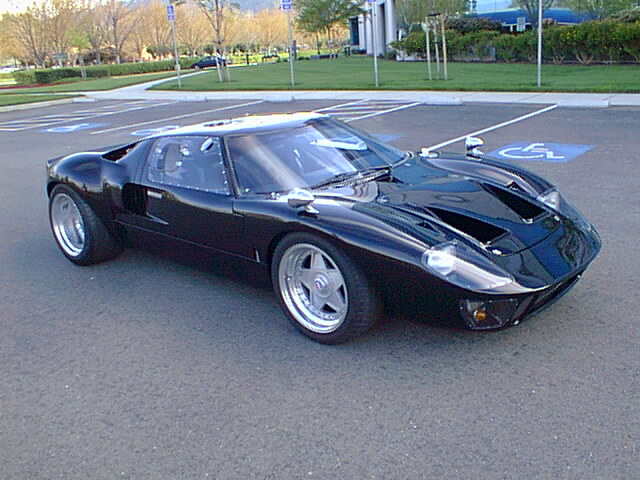

Here is another location,,If you like the air to hit you in the face. Putting it in the vent door is probably "cleaner" choice.
I don't know, but it sure is true. That is one beautiful car. Those steamroller wheels and tires don't hurt, either--
Why THANK YOU Gents,,, /ubbthreads/images/graemlins/laugh.gif You have made my day. /ubbthreads/images/graemlins/grin.gif
