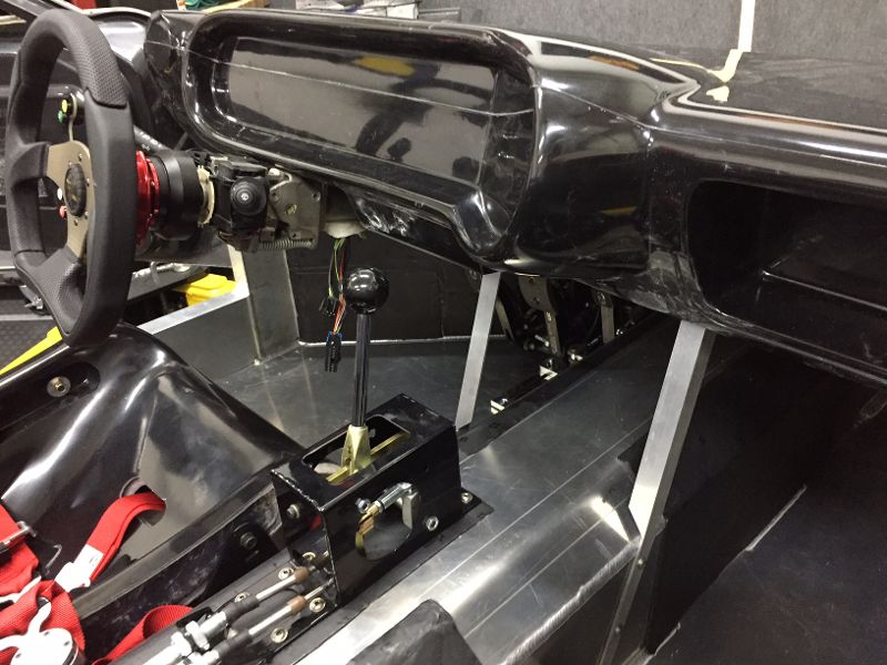

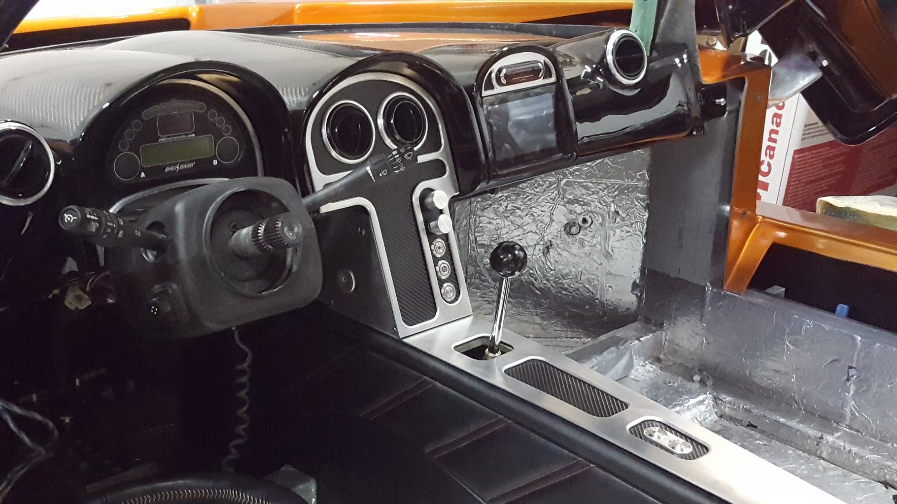

I finally got around to test fitting the dash, Koso gauge and steering wheel.
With the seat in the most rearward position and flat on the floor and the steering wheel positioned comfortably, I can’t see the Koso gauge through the top half of the steering wheel. Lowering the steering wheel doesn’t give me any room for my legs and also blocks a view of the gauge; the steering wheel won’t go any higher. I’m only 5’ 11”!
Anybody else have this problem and figure out a solution?

looks like you need to raise the steering wheel higher - koso or digidash, no way you could view the dash with the wheel like that. Maybe adjust the mount?
PeteB
It looks like your dash is sitting higher than it should. Is something stopping it from sitting flush on the top of the footboxes?

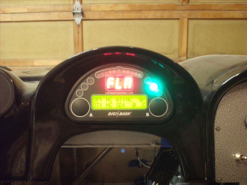

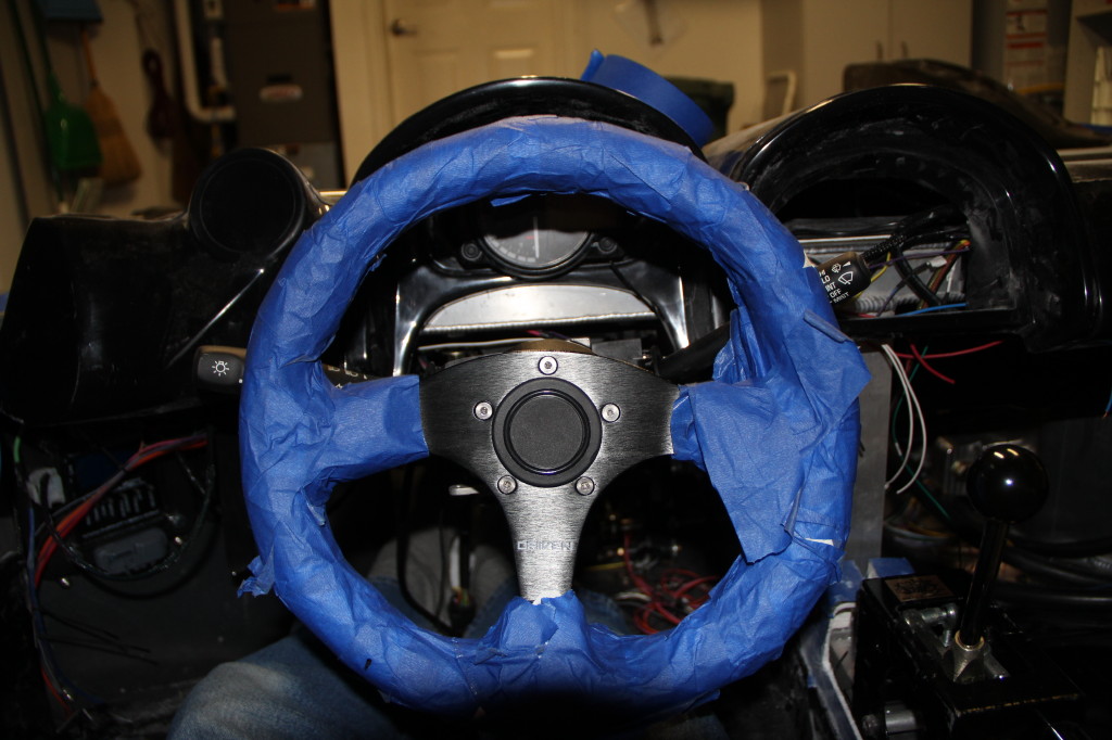

Here's mine:

I think Pete and Alex are right. There's plenty of visibility for a person your height with the gauge and dash installed correctly.
Smaller diameter wheels don't help any, but I think the first problem looks like a dash that is too high combined with a column that could be adjusted.
I'm a little taller than you, and I see mine perfectly, even with a range of wheel adjustments. But I have a slightly larger wheel than most.
I think it would help everyone if you stood back a little farther in to a better photograph. I think that everyone can answer will agree that we can't really see how your is sitting The chassis relative to the chassis. You should begin fitting the instrument panel once the body is set in place. Great idea of the correct height of the IP.

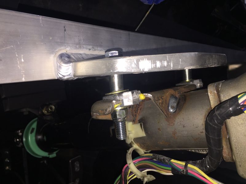

I am building the GT-R, but I had a similar problem. I "reverse engineered" and figured out where I wanted the steering wheel and relocated the steering column from the foot well wall to the base of the dash support beam to achieve that position. The mid column support bracket had to have 3.25 inches of spacer added to get the column approaching the dash from a low enough angle, then had to have 1.0 inch spacer at the dash support attachment point. I also shortened the steering column 1.5 inches.
I know the measurements will not apply to the SLC, but I found in playing around that the column mounting can make a great deal of difference in steering wheel angle and position as well as the visibility of the gauges.
i think his dash is fine. Looks like the same amount of crossbeam showing as mine, and my wheel provides perfect visibility of dash.
pretty sure his steering mounting is wrong (too low)

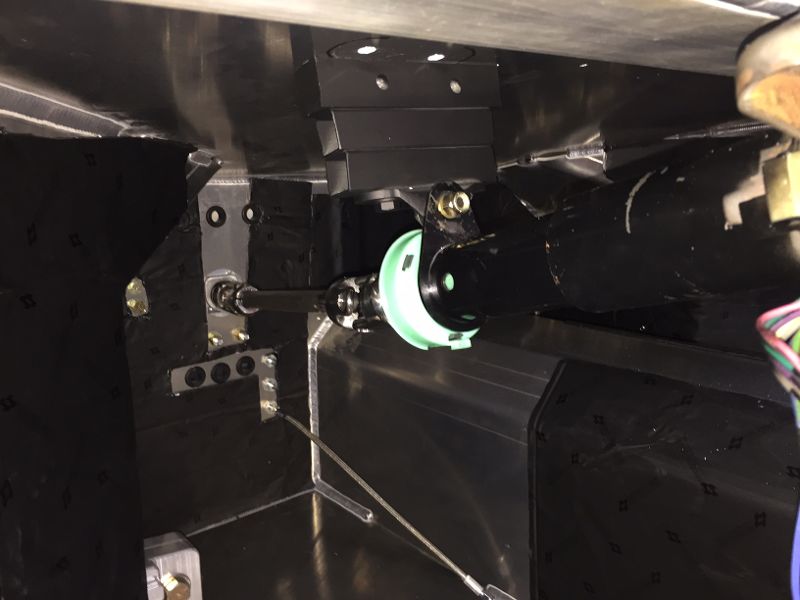

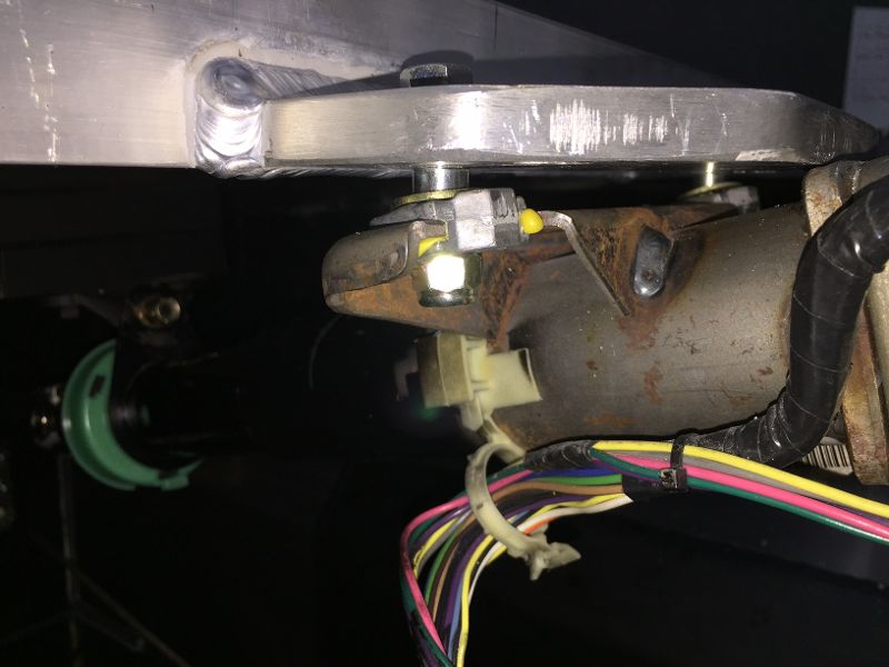

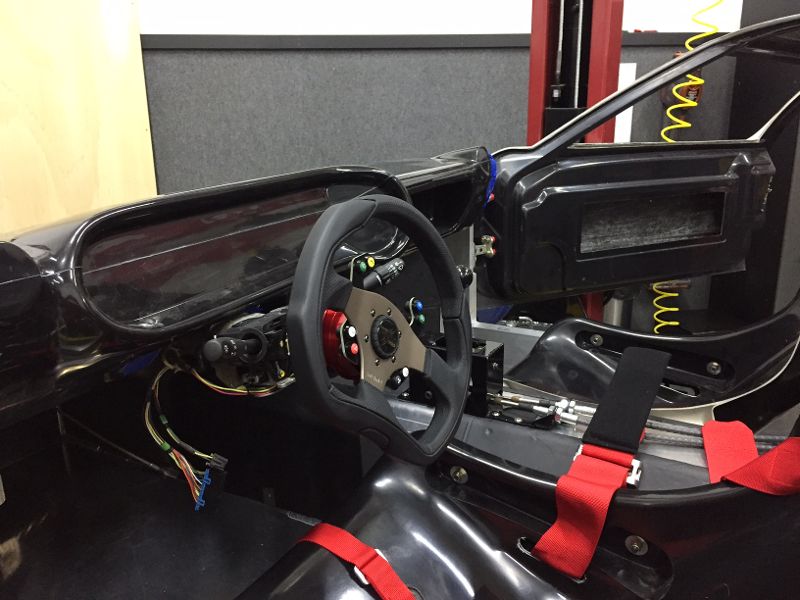

Again, I know this is a different car, but my problem was too flat of a steering column angle. The first two photos are with the tilt completely up and completely down, and the steering wheel was just too low. By putting spacers to change the angle of the steering column, the range of the tilt became usable. I had too short of a spacer at the dash support beam the first time. A longer spacer, further lowering the steering column, but increasing the steering column angle made it work perfectly. The last picture is with the tilt in the middle of it's range.
