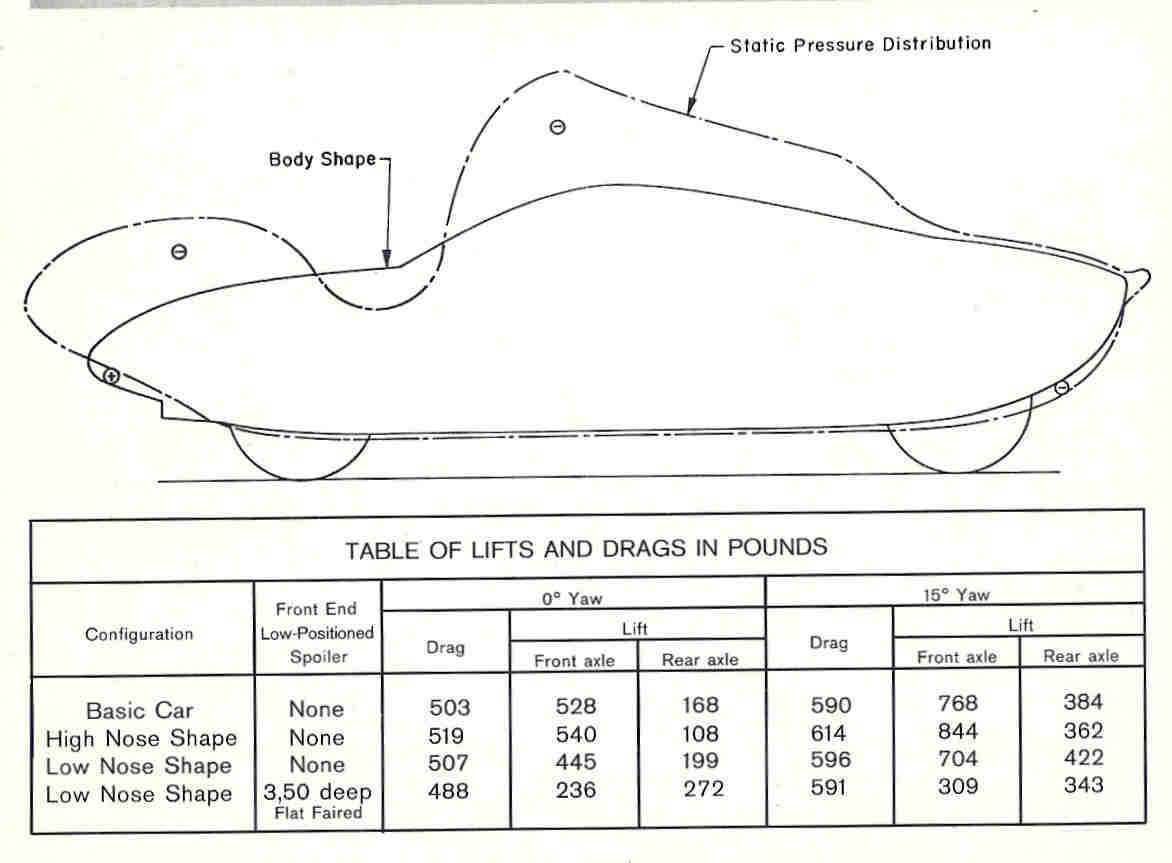

Quote from Goodyear regarding their Blue streak tires and the 1966 LeMans MK11 cars
The 2900lb GT40 Mk11 fitted with 427cid, 500bhp big block cars were exclusively designed to handle Le Mans and the infamous Mulsanne straight, a flat five kilometre's of country road. Here the cars would get up into high gear, winding up to close to 225mph. At that speed, the space between hartbeats is 330 feet. The tires would grab the track, turning 2700 times a minute, from there the cars would slow to 36 mph to take the Mulsanne corner. The tires and brakes would work together to dissipate over 4,000,000 foot/pounds of kinetic energy. The vented discs would glow at a temperature of 1500 degrees. Brake fluid would begin to boil. and it happened every lap for 24 hours.
It makes you think
Regards
Chris
Chris almost hit the nail on the head. How did these awesome machines do it though?! They didn't have fancy computers and ground effects and all this other modern day crap, but they did go 200mph over and over again and then brake for the Mulsanne corner, which is basically a 30mph u-turn. It's insane! It is exciting to think what it was like to drive a GT40 MK II with its Kar Kraft 4-speed. It's like, "Oh S---, I am going 95mph. . .maybe I should shift to second!" HA HA! I read another post and seems there are several GT40 replicas that can hit 200mph. I won't be the one to do it/ubbthreads/images/graemlins/grin.gif Have a nice day all.
