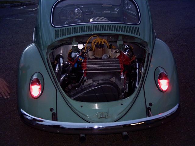

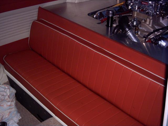

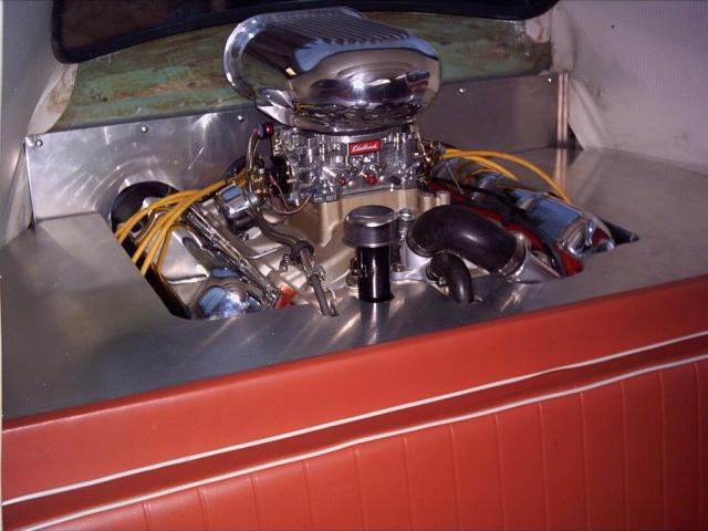

Its amazing what has been fit into VW chassis. This one was a little tight, but it runs and drives well.
Phil
