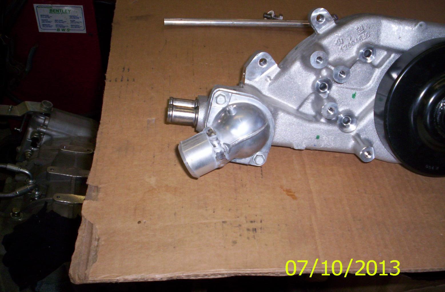

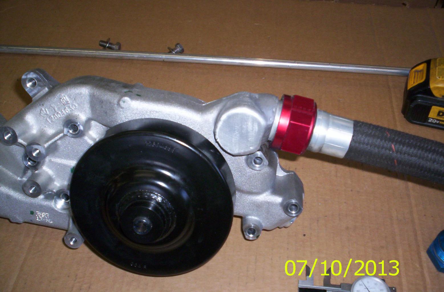

W Warren kreyer Jul 26, 2014 #5 PeteB said: Please show me some pics of the water pump mods required for a LS3. Thanks! Click to expand... This is what worked for me. Attachments water mod.jpg 161.2 KB · Views: 269 pump mod.jpg 156.1 KB · Views: 230
