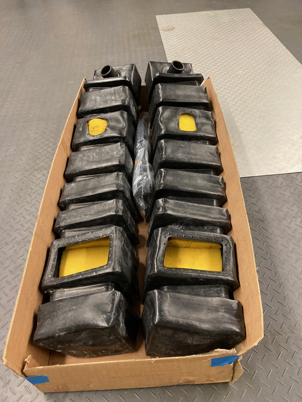

we did it !! succesful swap of Premier tanks on a Gelscoe
as my car is raced in international events, it needs new fuel tanks every 5 years. The old one where out of date, so new bladders and foams had to go in. The whole operation took us two guys about 3 days, also count the preparation for the swap.
The hardest part was to get the old ones out. We used lots of tyre mountimg grease and pushing, pulling and shoving. Both our arms look like after a bar brawl now !!
To get the new ones in, we closed the plate open8ngs with rubber foil and double sided tape, used a vacuum pump from our composite manufacturing and also lots of tyre mounting grease, as well as straps to tie it als together like a salami saussage. They were much easier to get in then out.
The tyres were off but the front suspensoin all stayed in place. We now have five years to heal our bruises !

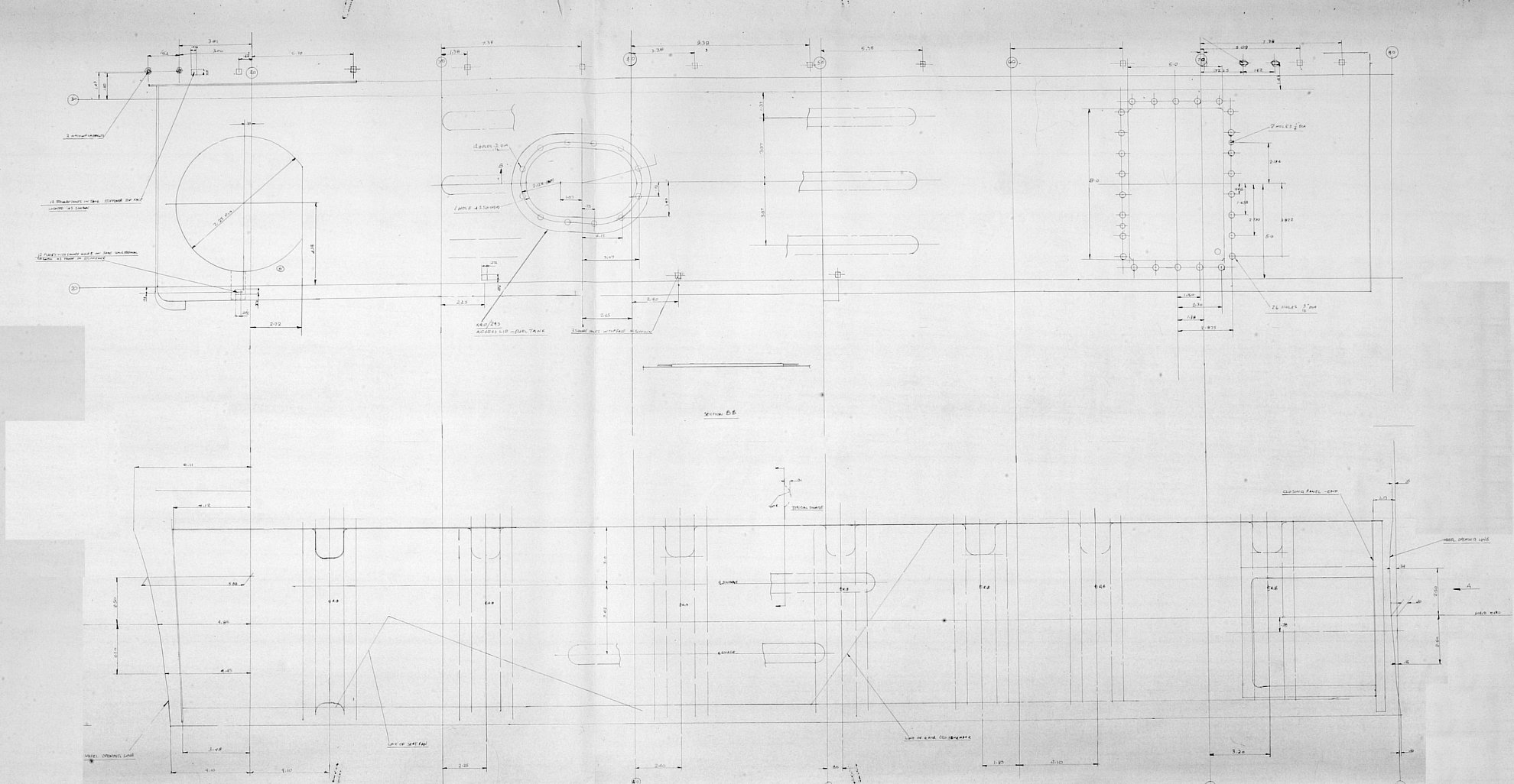

Would this help?
Finally had a chance to have a better look at it.
Interesting to note that it shows the ribs on the vertical inner face to the inside of the chassis where the seat is. Weren't these only a feature of a couple of the early cars, I think its mentioned in the recent anthology book?
Also, I think I am going blind, but where is cross section B-B on the plan.
Do we know what drawing number this originates from so I can save it accordingly.
in terms of understanding it, the square holes appear to be for the captive nut plates that were used to bolt the sill covers on. Do we know what these nut plates were? are they the same as the ones for the pedal box? (source where we can purchase these today would be great)
Also, while I am looking at it, are there holes at the front end for the Hartwell latch fastener?
