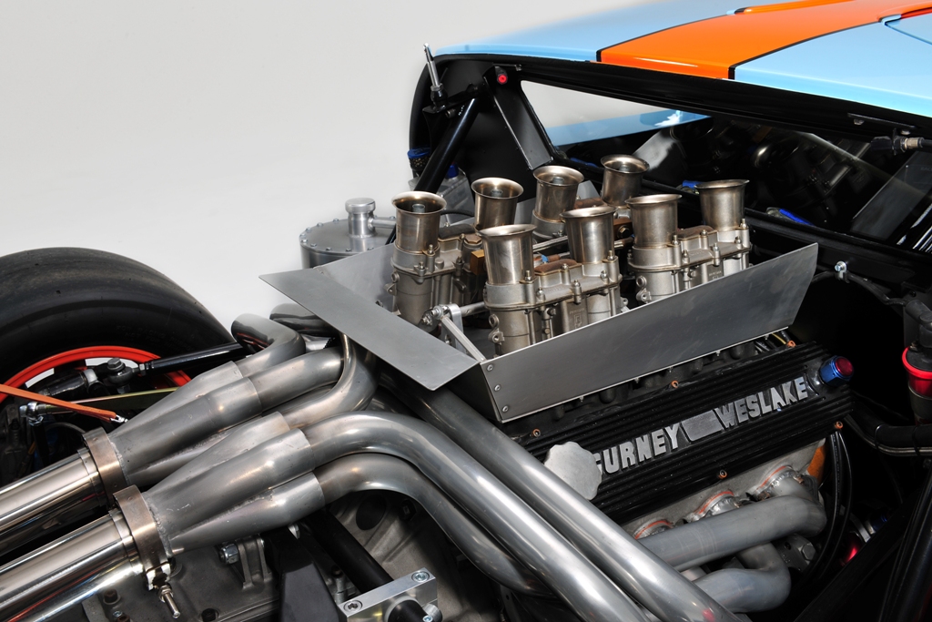

Weber IDAs on original Gurney Weslake heads, 548 BHP/540Ft/Lbs, no "reversion " plates, no stand off,
