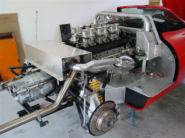

I don't know anything about tuning these things but I thought you might like a pic of this nice little group on the XJ13 they are 42 IDF Regards
