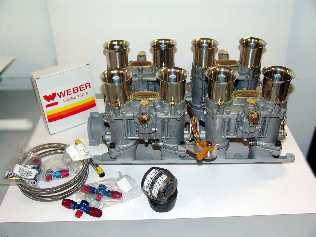

[ QUOTE ]
Post a picture of the webers so I can see what you got for the money. Also, Did it come with a unisyn? include it with the photo. In addition, if you have a brand new motor Break it in with a standard carbertor first. I would also put a couple of hundred miles on the motor because we all know that the engine get tighter as it breaks in. If you put the webbers on it early, you may have to play with the jetting and re-balance... or you may just have to tweek the the timming a bit/ This is only my theory! But for sure break in the car with a holly set-up!
Regards
Oliver
[/ QUOTE ]
OK, here's what I got. not shown is the tuning Book (not the Haynes biut the other one) and the jet kit and screen filters which are in the box.
