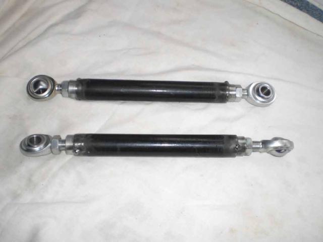

Is there anyone (fairly) local who could do me a small welding job? I can bring the items to them. I have two small suspension arms with rose joints. They are cut to size and the rose joint collars are tack welded in place, but as they are a pretty major structural component, I'd like someone with experience to run some weld round for me. I also need a stainless steel weld done (again, very small)

I would suggest TIG welding those ends in, much stronger and cleaner. Also plan on re-tapping the threads as they will shrink and if you force the rod ends to thread in they have a good chance of galling and may get stuck.
I usually drill a hole thru the tube before installing the bung to get a plug weld in the sides of the bung, just adds a bit of security to the weld.
A bit of anti-seize on the threads on installation will make adjustments later a lot easier.
