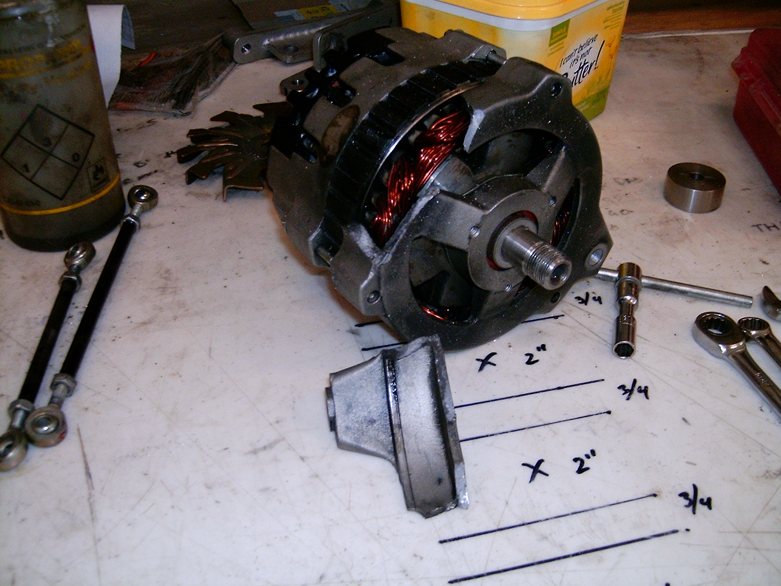

Doc this is what happened to my "one of these". So I replaced it with one of these. Mine is a GM version of the one you posted I think. The case looks stronger and that might be a factor to consider. I am thinking the best way to mount them is to use both mount holes to fix to a solid frame "girdle" and then use two additional points on the frame to attach the adjustment arm and the engine. This would feed all the loading into the frame piece. Making the frame out of steel instead of relying on only the cast aluminum case would hopefully help prevent the case from cracking.
Hard to verbally describe but I think you will get the idea...............
