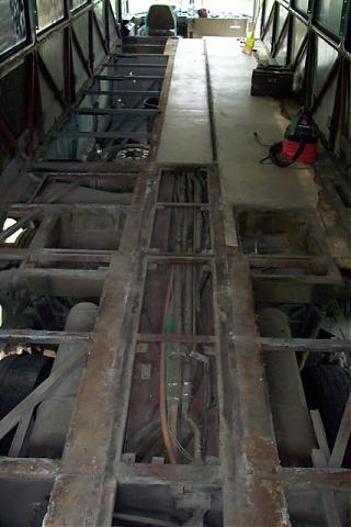

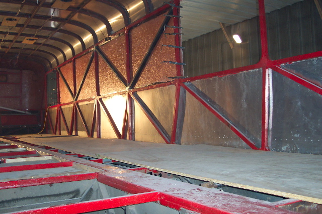

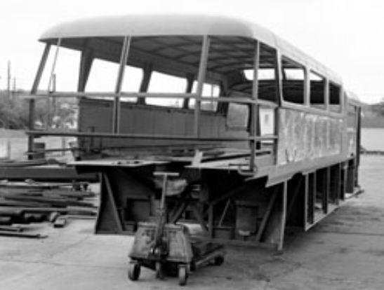

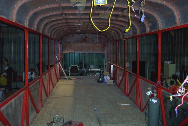

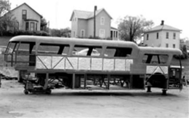

But it's the Aviation & Aerospace industry that has taken the basic premise of monocoque design to the levels of strength seen today.
Actually beyond airospace I believe the second widest use would be large transport. All over the road busses from the 50's to the present are a stressed skin mono

Certainly large trailers and busses etc used stressed skin support but when I think of the most extreme test of monocoque design, I think of vehicles like America's Space Shuttles. Not only do they have to be able to take extreme heat and aerodynamic loading, they have to be able to do it again and again while being capable of maintaining a roughly 14psi pressure inside while in a perfect vacuum (outer-space)..
