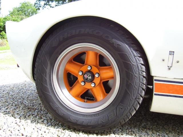

I found on the Cobra forum a reference to Hankook tyres. They now produce a new 275/60-15 V-rated, rumoured to be aimed at the SUV market. This size is exactly right for the back of my KVA and I bought them for £200 a pair. OK, they are marked as M+S in small writing but they look good and I have tried them at high speed in the dry on the Le Mans 13.2 km circuit at the July Classic, and on the road in the wet and can find nothing wrong with them, although to be fair I didn't go faster than 150mph. The front tyres are much easier to get and I bought W-rated Continental 235/60-15, again, no problems. With fitting, balancing and tyre disposal, I paid a total of £410 for all four. I had budgeted a lot more than this, and am highly satisfied. I run with 25 psi front and 21 psi back.
Tony.
I think the profile may push the rolling circumference out a bit? Do you avy pics and can you give some ideas on diameter and rolling circ? cheers Chris

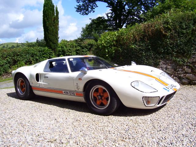

Here are some pics of the 275/60R15 :
Tony.
