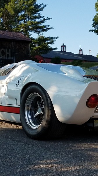

Posts 185 and 216 of my build log (Classic Car Developments Chassis #3) show Avon 295s on 12 x 15 rims.
Thanks Eric.....looks awesome
Any issues with clearance or rubbing with the rear deck ?
No issues at all. I have the stock faux knockons that have "GT Developments" stamped on the inside...I have 215s on the front. Wish I would have gone up a size although THEY possibly might rub. IDK...
