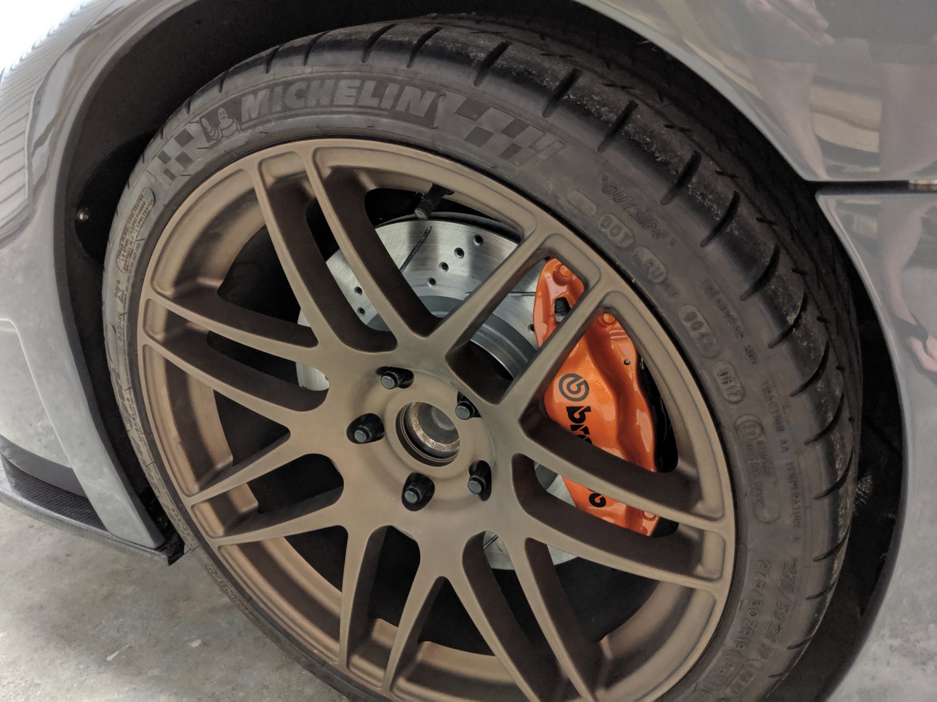

Here's a picture that (somewhat) shows how close the F14's are to the 4 piston Brembo, other wheel styles may have more clearance than I do. I haven't checked front travel yet, but appears I have a little room to run a spacer up front assuming studs are long enough to compensate for it.
