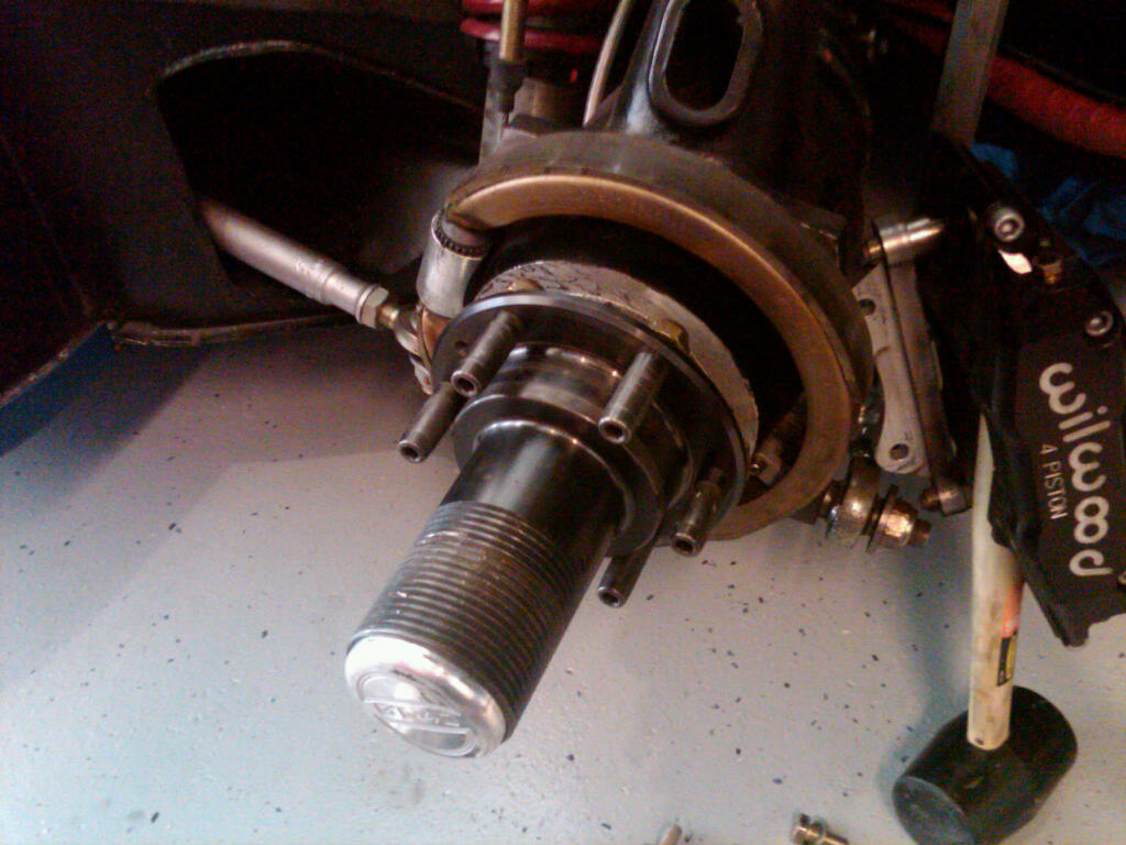

I finally had time to look at it tonight and while I am not sure it is the problem, I did find one issue. The brake rotor has a bit of play in it. I am uploaded the short video of it showing that if I pull the top of the rotor it makes the most noise. Any thoughts on the issue and how to tighten this up?
I checked all bolts on the rotor, they are fine, two of the pin drive bolts spin a bit but I cannot seem to figure out how to get the outside plate off.

Kevin I don't think our SPF cars have floating rotors. The brembos on my ferrari do have, its for heat expansion and contraction. Its not the wheel bearing but the rotor that is doing that?
I think it might be the wheel bearing since the other side doesn't float; it is certainly a problem.
Looks like I need to get a stub axle remover this week to get into the bearing.
Can you grab the centerlock hub extension & feel play in it when you lift it up/down, if so its the bearings, if not its the rotor hat loose on the pin drive studs which IIRC & since you say a couple are loose the nuts that tighten from the rear face [ which you probably cannot see for the hat/rotor ] must not be tight.
Seymour Snerd
Dennis O has a tool for dealing with this that (I believe) he will either loan or sell you.
He sells the puller/installer. Not cheap but a good product. If I was you I'd make friends with one of the guys on here and rent the puller from one of them. While your in there you might want to do the E-brake modification. It's worth the little extra time.
Correct

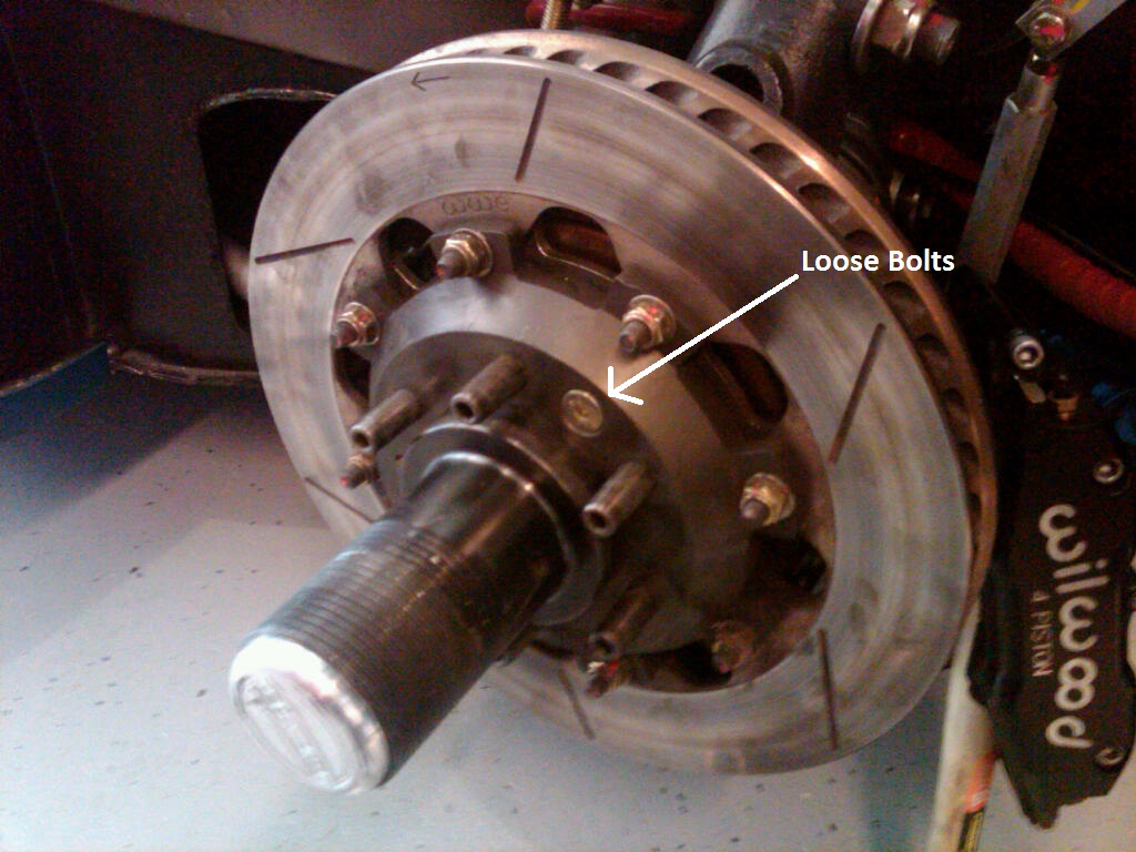

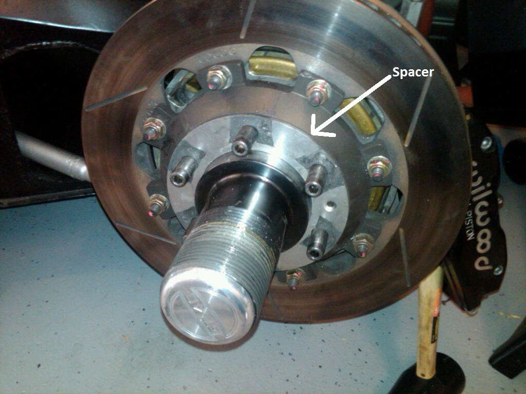

I am a bit embarrassed to even post this but what the heck. I am still getting used to working on the car and similar to a new girlfriend, you don't always know if touching them in the same spots will get the same reaction... after sometime you realize that even though she looks like super model, she is still built from the same parts.
So the part that stumped me, after spending an hour building a quick jack lifting bar out of a 4x4, was the spacer; opps
Once I figured out that the spacer was between the wheel and the rotor, I found the two bolts holding the rotor to the hub were loose. I spun those off, took off the caliper and rotor to tighten up the pins. Put it all back together and the noise at a low speed is gone.. amazing that when all the parts are tight the car sounds better.

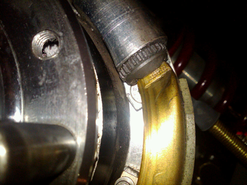

I did take a look at the e-brake hardware while in there, looks like I might need to do the fix as detailed in the thread. Will keep an eye on it.
Thanks for all the help; like I said, bit embarrassed that I could not figure out the spacer simply comes off and that two bolts would fix everything.

....Once I figured out that the spacer was between the wheel and the rotor
How thick is the spacer? (I don't have them, but it's not unusual for me to discover missing or extra parts in P2160....:huh:) Also, do you have them on front wheels as well?
While the countersunk screws might have been loose as well, it was the loose drive pins that were actually causing the problem, I would also suggest that you measure the ID of the wheels in use where they sit on the register @ 'A', if they are not a snug fit here then further problems of this nature are likely as it then makes the drive pins load bearing as well.
edit..In my earlier post I had assumed that the drive pins also clamped the rotor hat onto the flange, this is obviously not the case & the hat simply slides over the drive pins much like most situations, if the retainer/countersunk screws are/were not fully tightened then they might have been responsible for this initial problem, also with the wheels off & those screws loose any road grid/h/brake residue can become entrapped between faces which will cause a 'false' tightness when the wheels are refitted, cleanliness at all times reqd...
