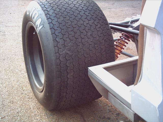

Tom
Looks like a nice fit to the chassis. Do you know the width across the top of the rear tread side to side? I am using a 15 X14 wheel in the rear with avons and I measure 76", (193mm) to the top of the tread, and approx 78", (198mm) to the outside of the tire. I was just curious how close to that you are.
Phil
Phil,
With the +2" wide track (each side) suspension mounted i have the following dimensions:
outside to outside: 73,5 " (1867 mm)
trhread to thread outside: 72,5" (1842 mm)
I wonder what the size of the wide orignals was ?
TOM

I think I recall the originals being 14" wide..
Tom
If I remember correctly the backspace on the original BRM wheels was 4 7/8", so with an original track of 56", that would leave 9 1/8" on each wheel. So 56" + 18 1/4 makes it approximately 74 1/4". I think that pin drive adapters might add a total of 3/4" to the overall width on some setups. Overall as long as suspension and body work clears I think most chassis will end up in this general area. I have no adapters on my rear uprights, but my bodywork measures 80" inside lip to lip, and I wanted to fill the wheel opening without rubbing.

This confirms the original dimensions of the RCR 40, nice to hear.
I´m in the process of making my own flares now and realised of you go to close with the flare radius towards the top outside of the wheel it touchs the flare arc by moving in at app 10h and 14 h ( don´t know how to express it otherwise) so i need roughly a distance of 3/4 of an Inch from the vertical upright out line of the tire towards the top inner flare arc.
