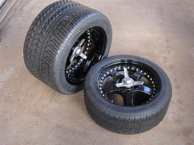

You can can come and borrow mine if you want to see what they can look like John. They are Image 17 with the fake spinners and gold powdercoat centres.
Brett

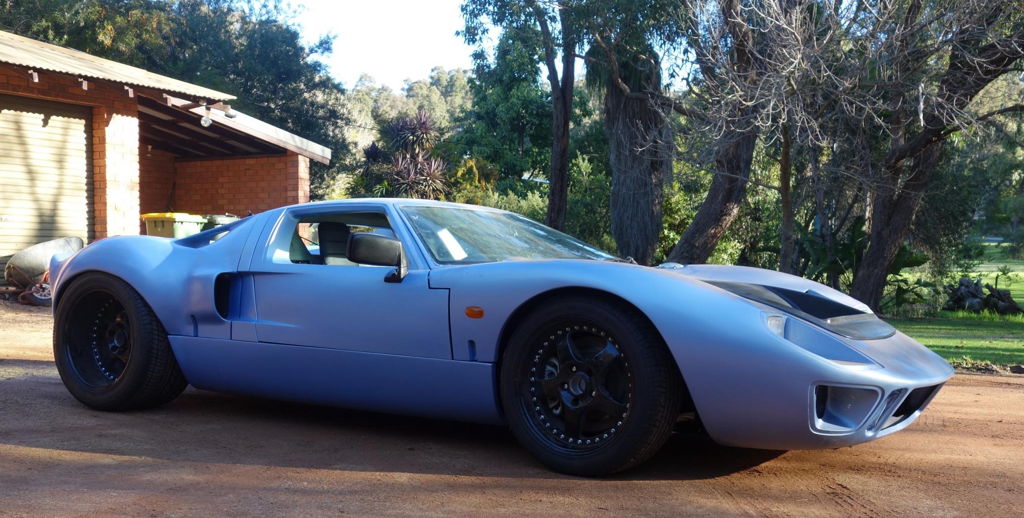

Somewhat similar to BRMs, but 5 spoke. 17 inch. These aren't made anymore, but other manufacturers do similar wheels, I believe.
Cheers,
Lance

Tyre size choice is critical to get the ride height. You need to go for 24" high tyres on the front and 26" on the rear to make the car 'sit' right.
I went with Kuhmo KU31 235/40 on the front giving a 24.4" and 285/40 on the rear giving 25.98"
Should have probably waited with the length of time they have been sitting there now....
Brett
