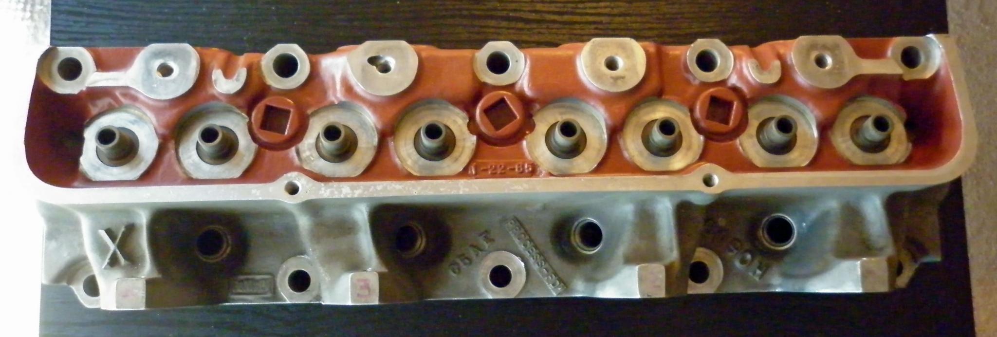

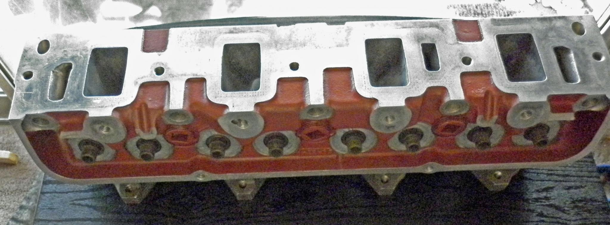

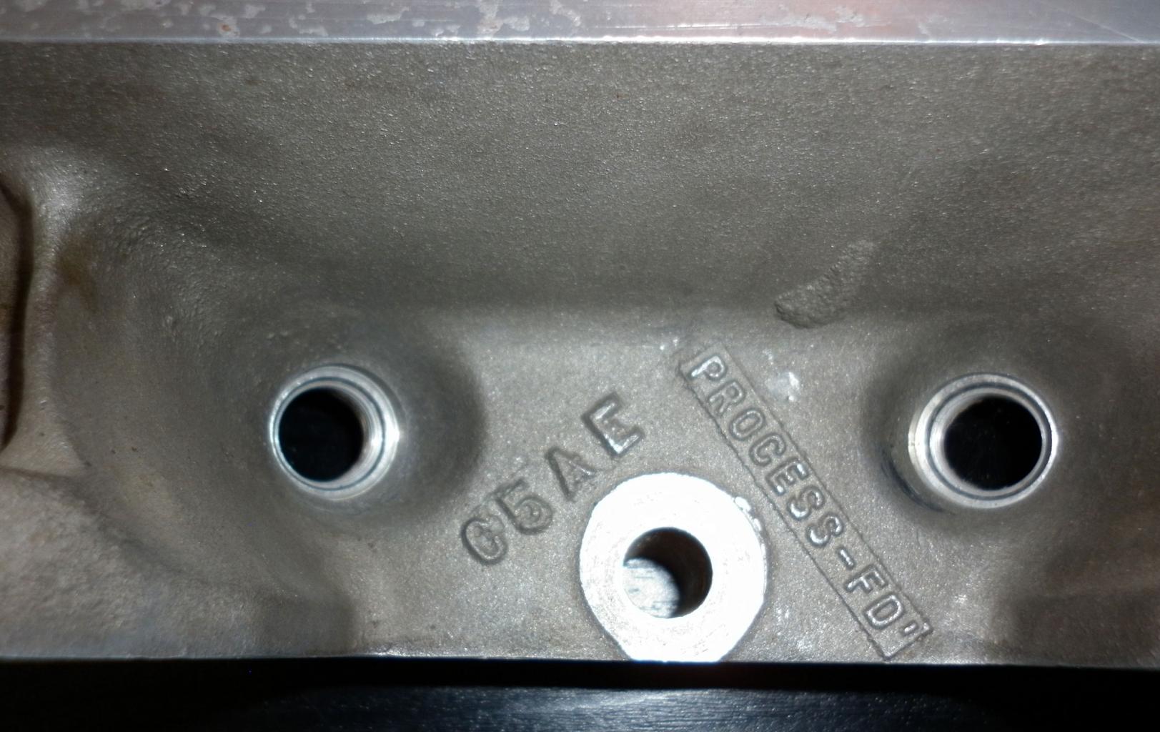

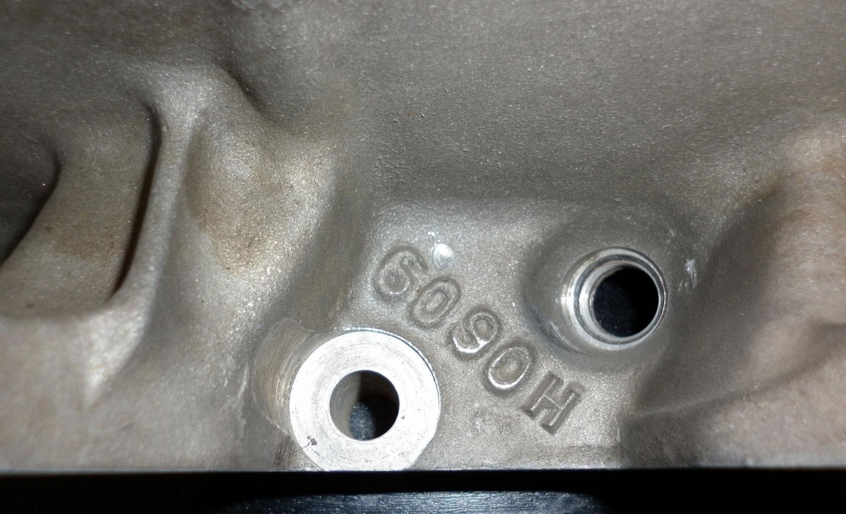

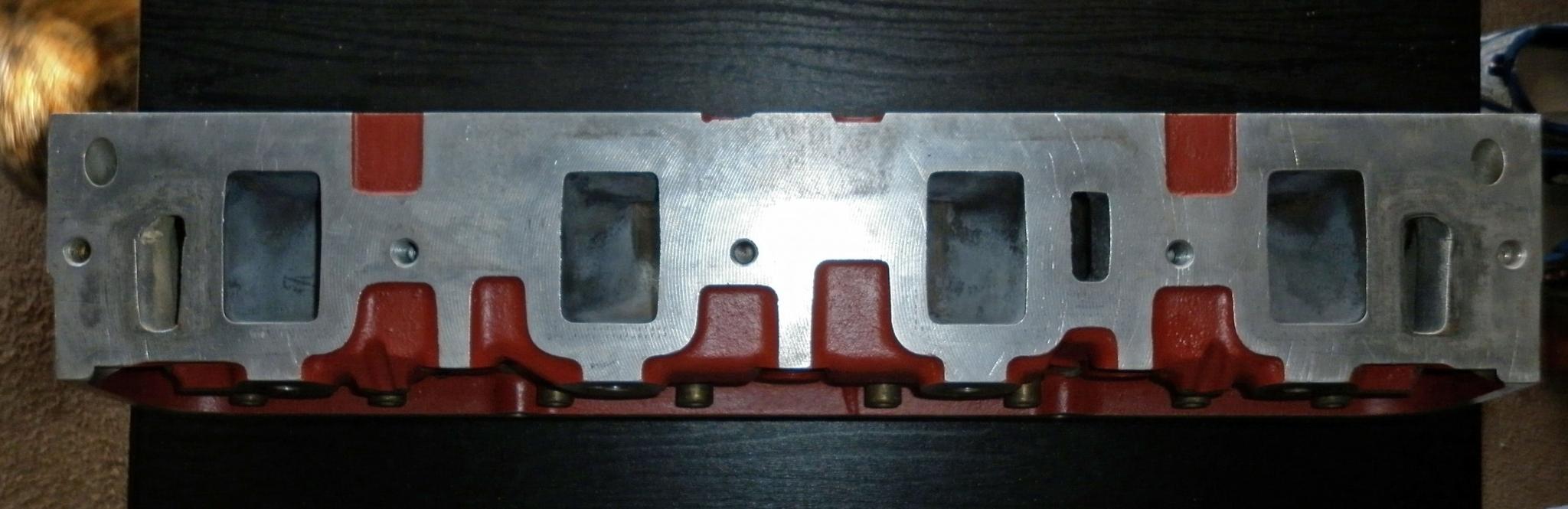

Just a little more info. I got these pictures today from a old friend. They came on a Cobra he's had since 1969. It's not an S/C but has a roll bar, and side pipes. I went with him to pick up the car. The college student he bought the car from said the magnesium intake manifold (with an offset Le Mans bowl 780) had disintegrated a few months earlier. At the time we'd seen many 427's my friend even had a few but neither of us had ever seen a set of aluminum FE head's. Not sure where I heard it but I think these are low riser head's but were bolted to a side oilier block. Enjoy the pictures it was nice of him to share. So is the casting mark "H0609" or "6090H"? I also love the big "X" casting mark. Gee it couldn't be Experimental, lets make sure no one knows?

Yes after talking with my friend again he did say they were medium riser heads. Also I was wondering why that number seemed so familiar, My friend and I worked the parts counter at what was Russ Davis Ford of Gas Ronda fame.
