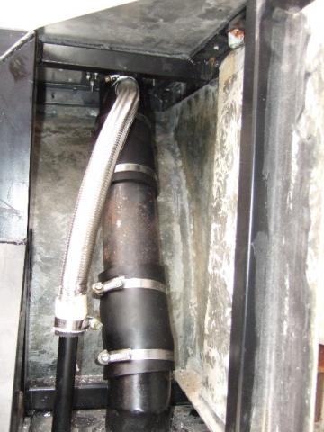

Whilst the breathers on our fuel tanks are not ideal, I think the issue also results from the foam/exploso safe fillings in the tanks. The fuel runs into this and backs up enough to trigger the fuel handle cut off or overflow out over the driver. If the tanks had an area where the fuel ran into a slightly bigger void just inside the tank it would then flow through the foam/exploso safe by having a larger surface area to be absorbed and so the back pressure (for want of a better description) will be reduced or avoided. This would also releive the fuel trying to go up the tank breather pipe too. I am building a 90 to 100 ltr fuel tank now for another car. This one will have the immediate void for the fuel to rush into giving a bigger surface area to dissipate from plus there will be two breather take off pipes, both in the back half of the tank to prevent them getting "blocked" by fuel trying to go into the tank. I guess bag tanks don't suffer this issue. My GTD suffers from this and I have learnt that if I fill up a bit more slowly with the pump nozzle nearly back out of the filler neck, the problem is greatly reduced and only takes a little longer than normal. I maybe have the pump nozzle half an inch into the filler neck. And I watch closely!!!! I did hear of one chap who used a broom handle to shove into the tank to push the foam/exploso safe filling back to create a void but to do this you will need to get access into the side pods of the car, a bit of a faff but perhaps worth doing if you are really suffering!
Ian Anderson
This is the Dax system - seems to work very well - I pump fuel at max flow
It will fill to about 7/8 tank without problem then the pump will click off
After that about 2 more squeezes of the pump fills to below the cap.
No foam in ank just explosafe wire wool stuff
