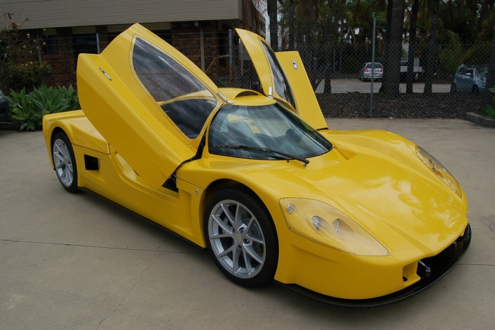

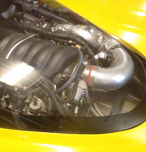

Would photos such as this be helpful to you? I have a bunch should you wish to take a gander.
