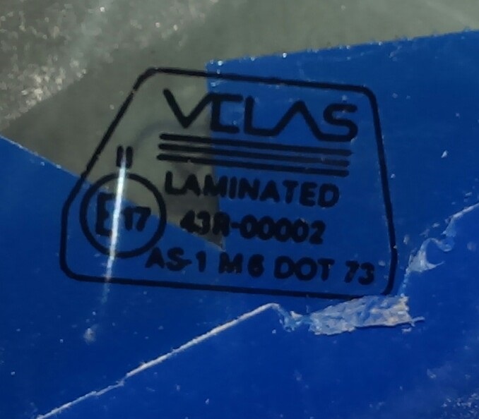

FYI, the manufacturer and part number are the same as the windshield on my CAV. I've always found them very responsive to parts requests so if they are in stock, they may be a faster supply route.
Here is one to add to the list if looking for an alternative in the UK (Suggest Fran if the US).
