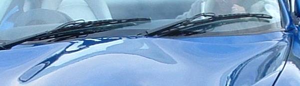

Mark
Here is a picture of the system on a TVR Tuscan. It's a loop of black nyon tube with holes toward the screen.
Regards
Steve

Thanks Guys, helpful as always.
Phil - Thanks, it might be possible to get the same thing from a Vauxhaul van here in the UK. I also like the idea of the check valve to keep the line full. Saves any dry wiping of the screen.
Brett, 407 sounds like a good option also. Shouldn't have any probs getting one of those. Did it fit the Lucas splines or did you have to mess around with it?
