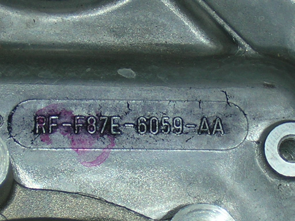

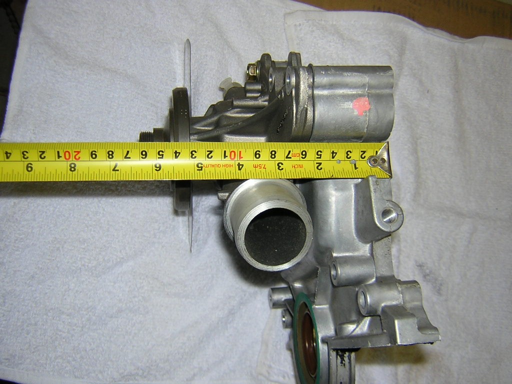

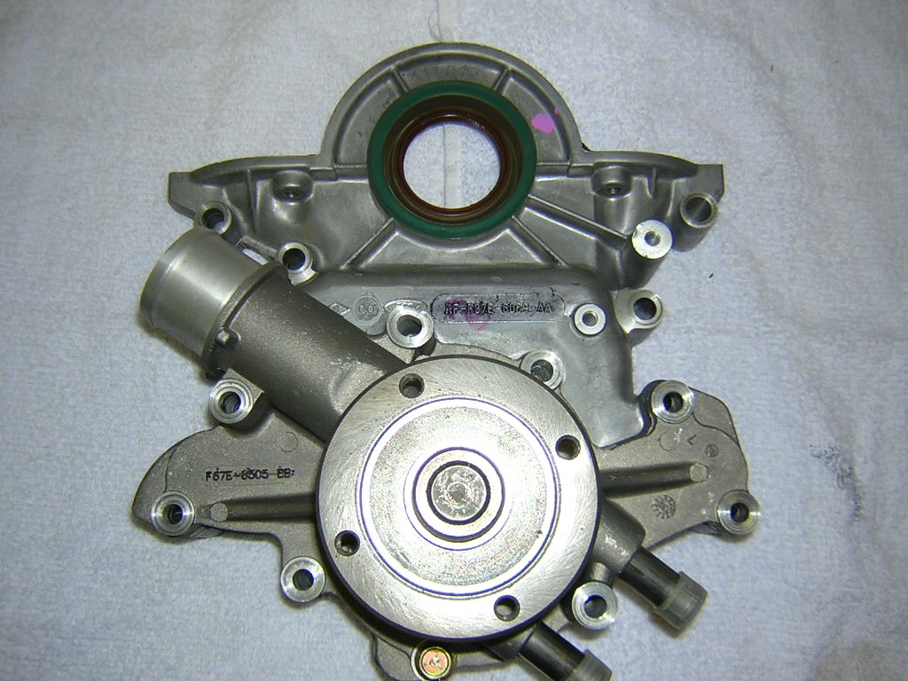

Maybe a little visual can help. /ubbthreads/images/graemlins/grin.gif
Thanks guys, that is one short pump , and thanks Hersh for the effort on the pictures.Im starting to gather my engine parts that I need to get the long block all built and buttoned up . Not speaking "Fordese" and being of the Chevy dialect has made this tougher for us fereners, LOL /ubbthreads/images/graemlins/crazy.gif /ubbthreads/images/graemlins/grin.gif

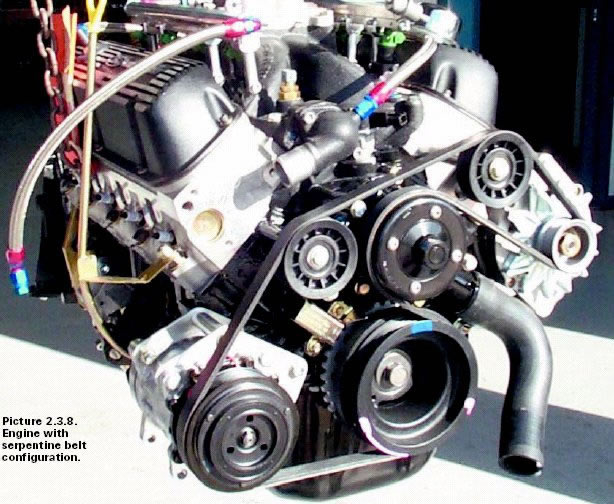

After looking back at the 2005 catalog , I think the correct numbers would be M-8501-A50 for the cover and pump, and just M-8501-D50 for just the pump.I realize there are numbers on the castings, but I think that may be the same units ? That or they are no longer in the motor sports catalog. Maybe Hersh can take a look and confirm , that way the next guy can use this info. /ubbthreads/images/graemlins/grin.gif Dave here is a shot of RFs serpentine setup, looks like you would have to do more than just use a shorter belt, due to you wouldnt have enough of a wrap on the crank pulley.Photo courtesy of Roaring Forties

Why eliminate the belt driven pump? Nothing is for free, that is, it takes energy to drive the electric pump too.
The mechanical pump keeps the RF's plenty cool (much more a function of cooling design than type of pump, ask Blackjack who tried everything, including e pumps, until Robert told him what to do to get his ERA right) in hot weather with no issues. I doubt you could get an electric pump that would be more compact, simple, and reliable than the shortie SB Ford serpentine pump setup.

The thread is correct in that the shortest waterpump for the SBF is F67E-8505-BB. This unit is found on the 96 to 2000 Explorer. The new information is that you will not find that part number even as a cross referance on the Ford database. The part number to use is F87Z8501CA PUMP ASY - WATE. That will get the correct pump marked with the BB ID number.
