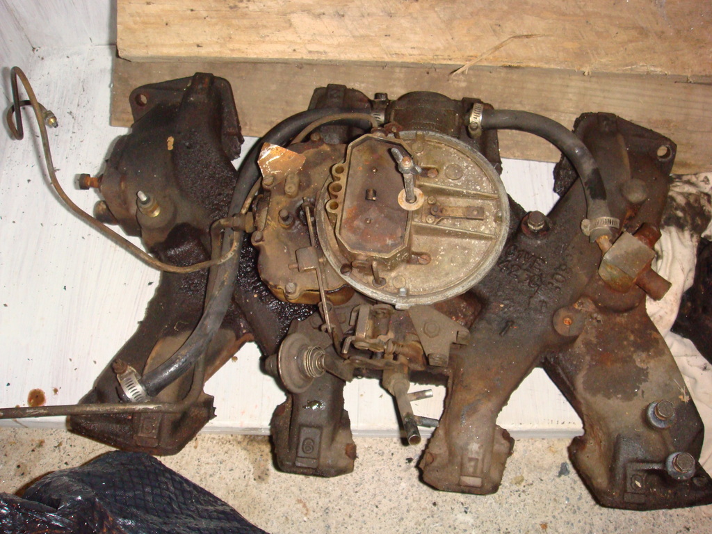

If a Lincoln 460ci can breath through the below carb (not saying it's optimal, but it is stock) then four big 48's should feed just about any Ford V8.
With a smaller choke v. displacement then one gets really good (ie. fast) flow and great atomization.

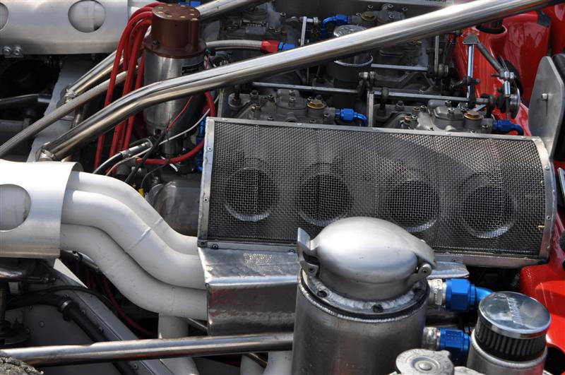

They are very rare. The SBC setup was only fitted to Grand Sport Corvetttes and Lola T70s as far as I can tell. Mine were original to the car but I have never seen a complete setup for sale.
