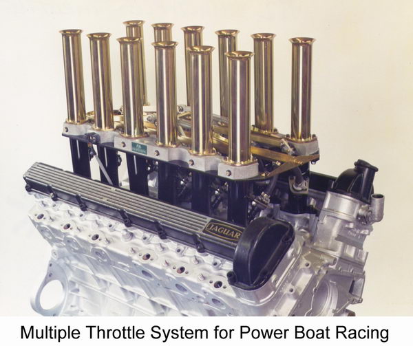

C'mon! You know you want to.......... /ubbthreads/images/graemlins/cool.gif

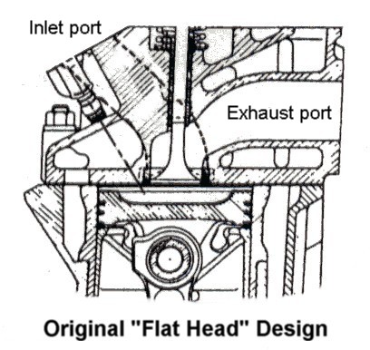

Hey Ron. Re: V12 availability. best motor to have is the '71-81 European motor as they have typically 10.1 cr and the "flathead" cylinder head design can develop extra horsepower 500 and above with absolutely no problems. The best one out of that range is the mid 1980 production. This was the basis for the 6 litre TWR developed motor in the race cars. After that (1982 onwards, the "HE") they enlarged the chambers to encourage mid range fuel economy and you are limited to about 400hp with these. But, they are cheap. I have just been offered an'89 HE with 60K miles in perfect condition complete shipped to my house for £475 - $900 US at today's rates.

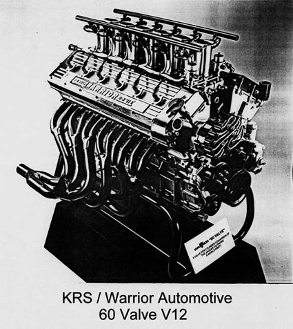

But not like this one!!! (special one off 60 valve - ouch!)

Go for it, but try and get THESE cylinder heads!! /ubbthreads/images/graemlins/laugh.gif
