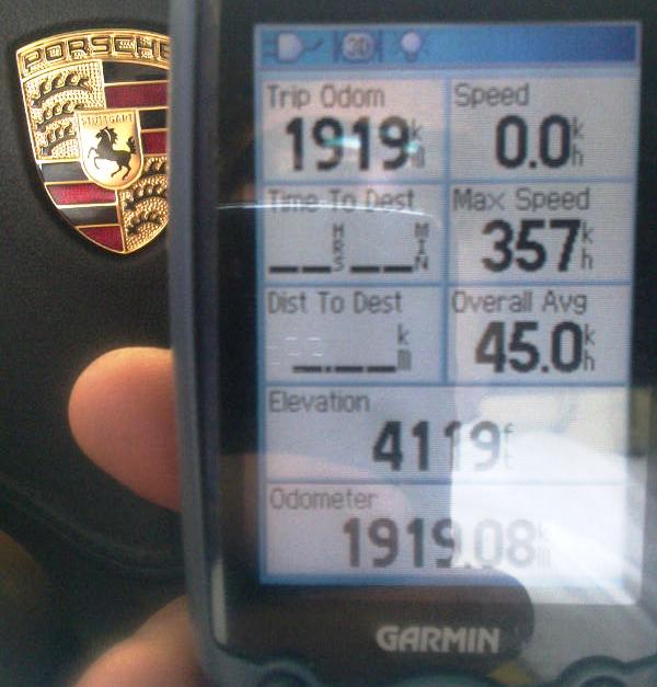

Here is a picture for referance. That converts to 223MPH for yall south of the boarder. :shifty::shifty::shocked::shocked::lipsrsealed::lipsrsealed:

Please tell us you're doing that on a track and not on a public roadway......
