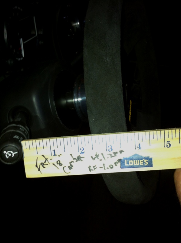

Hey Guys...I have another question for you. The guy that I asked to weld on the steering adapter left it about 1/2" from bottoming out. (I was hoping he was going to push it all the way on, but I think he left himself room to tack it) Anyways...I feel like my wheel might be too far away from the control sticks. It's driving me f'ing nuts.
What do you guys think? If it looks fairly close to what it should be, and you guys think it's alright...then I'll leave it alone. If it looks too far off then I'm going to source another steering column and quick release. Hopefully Fran has one to sell. What a waste of time...
Yos. Pm me. I have mine that is not modified we might be able to trade if it can work. I also might have another stock one you can have if I can find it.
Yos, sorry about the crappy photo attached, but 2.5" to stalk feels good. If it's too close your knuckles will hit it during "aggressive" driving.

Thanks Mike...That's really close to where mine is. My stalk is a little closer to the 2.75" mark though. That being said...your quick release looks much closer to the column than mine does (Maybe even an inch or more)
But our stalk to wheel distance is within 1/4"???
Looks way closer than mine in the pic...
